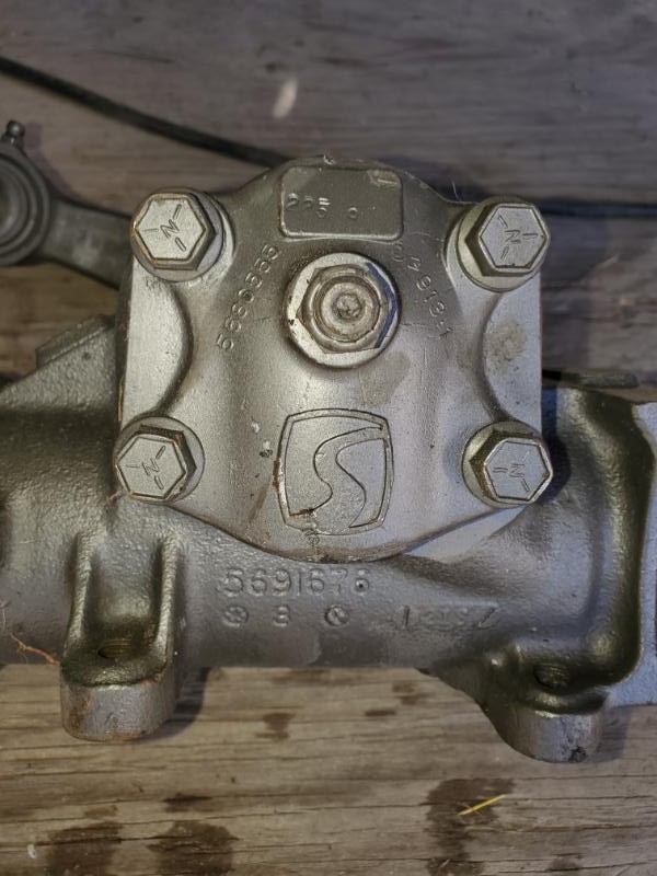

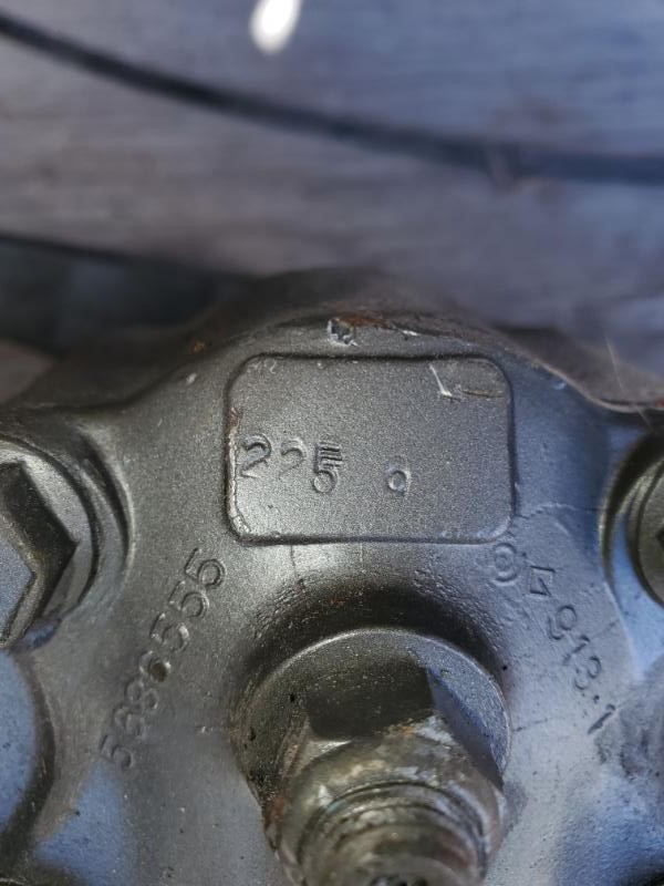

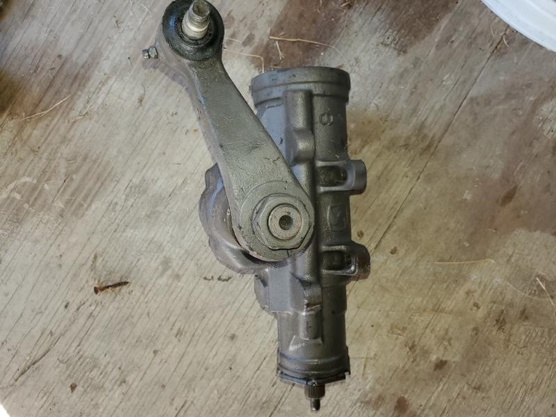

jl8z28 12-14-2020 10:11 PM
Power steering
2 Attachment(s)
I have this
X77Z28MP 12-14-2020 11:22 PM
nice piece but wrong date thanks for posting Still looking not much out there
jl8z28 12-15-2020 02:18 AM
Can you tell what the year is it could be a 8 or a 0
X77Z28MP 12-15-2020 12:51 PM
Looks like a 0 anyone else see a 0
