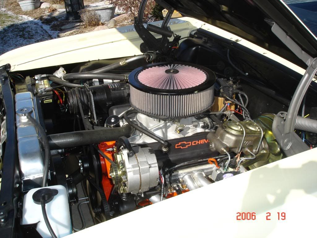

A little past history on this car....... I bought it back in 2005 and did the Body and Paint, suspension, brakes, and added a 406 small block and 700R4 trans....... Great car... Took it on it's first of many Power Tour Long Haul's in 2006..... My son Chris got the car in 2010 and continued the tradition of driving on the Road Tours
https://hosting.photobucket.com/albu...s/DSC01817.jpg
https://hosting.photobucket.com/albu...s/DSC01812.jpg
