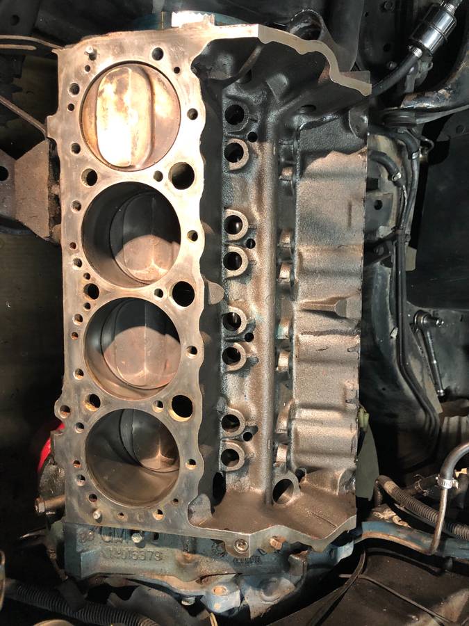

1 Attachment(s)
I have a over the counter LT1 short block that PO had put a unknown hydraulic cam and was wanting to see what would be a good cam that may make this live on 93 octane I have no issues going back flat tappet or even a street roller BUT have to fit under stock Vette covers no poly locks want this to look like a stock 302
mildly smoothed 186 heads
472 intake
