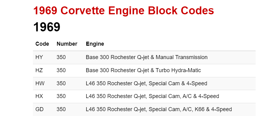

Does this help?
https://i.postimg.cc/50Yjd5c7/screenshot-9361.png

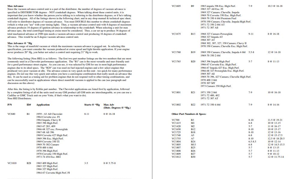

MarcDant 12-09-2021 05:26 PM
chart
1 Attachment(s)
This might help.
