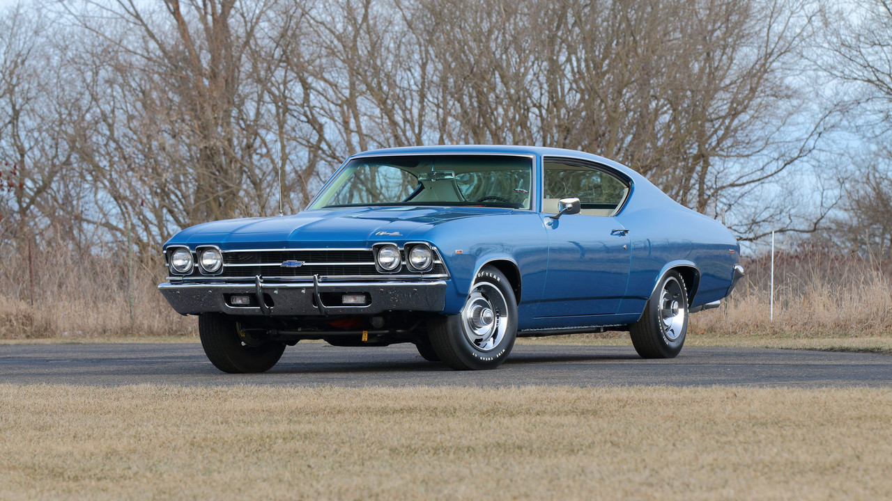

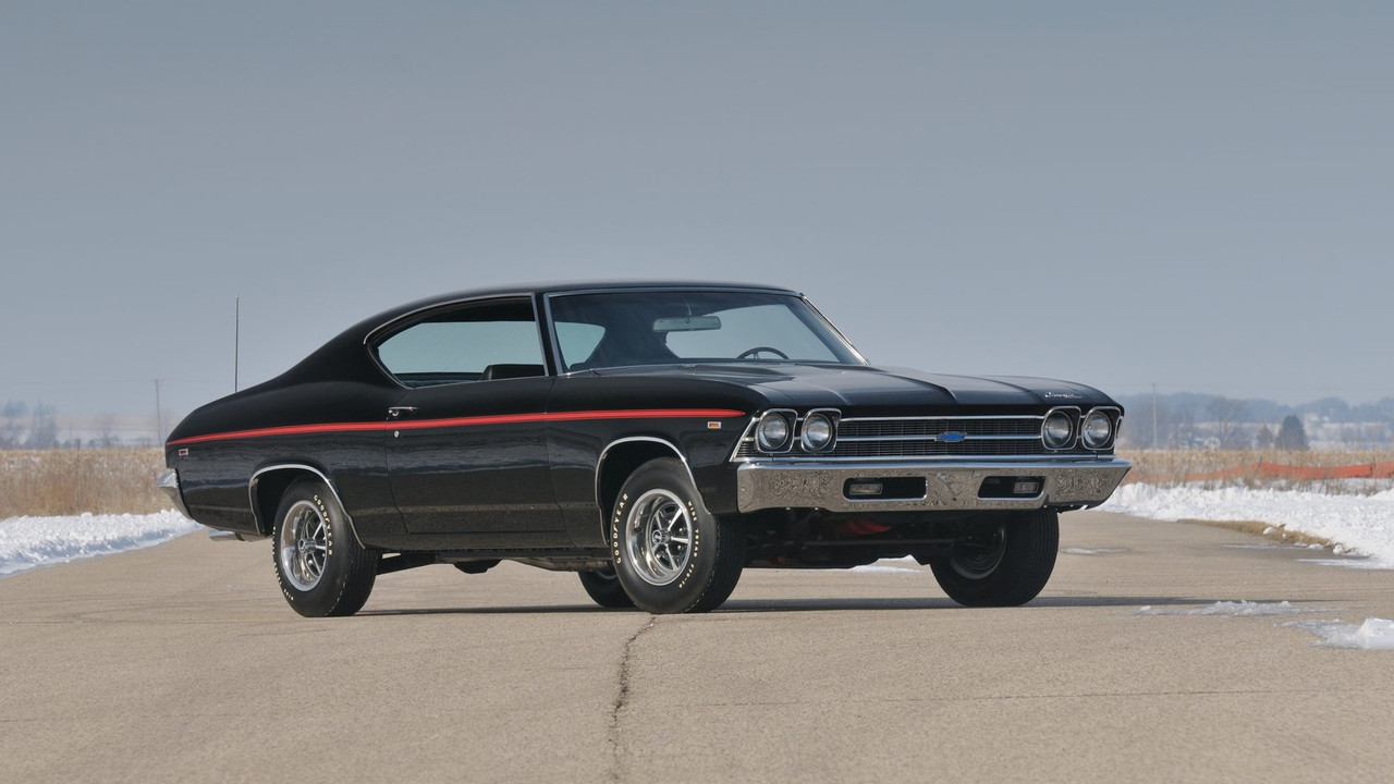

Lee Stewart 03-07-2022 11:31 PM
https://i.postimg.cc/hPG1dNrD/0s.jpg
https://i.postimg.cc/Nj98NTSZ/0.jpg
AFAIK, the 15" Goodyear Wide Tread GT F70x15 were only used on the 9737LD COPO Chevelle.
