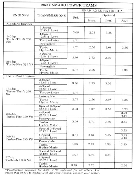

Lee Stewart 09-19-2022 04:06 PM
Originally Posted by Too Many Projects (Post 1600350)
My '67 SS 350 was built with a PG and 12 bolt.
May not apply to the '69 model year...:confused2:
That powertrian option was still available in 1969:
https://i.postimg.cc/vByj01gr/screenshot-10792.png
