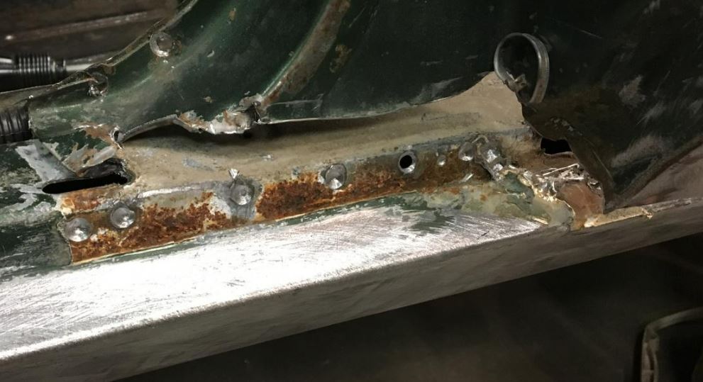

1 Attachment(s)
This is a picture of removing the original LH quarter from my 1970 nova. There was no indication of previous damage or repair here. You can see some brass at the front lower corner from the front edge of the seam inwards towards the inner rocker. Nothing along the outer seam to speak of... maybe a little flowed back... mostly in the inside lower corner.
I also found similar brass in the top inner corner of the B pillar at the roof rail.

x44d80 10-13-2022 08:07 PM
1 Attachment(s)
Thank you for the picture but it need a picture of the joint looking toward the front of the car. Yes the quarter is brazed on a Camaro there also, at least on 3 of the cars I removed the quarters on. The picture I need would be between the point of the rocker spear and the E on the tire. Excuse the photo, its off the Net. Best regards, Brent
L78_Nova 10-13-2022 08:12 PM
Will look for a photo, my memory says yes but I don't trust it anymore.
