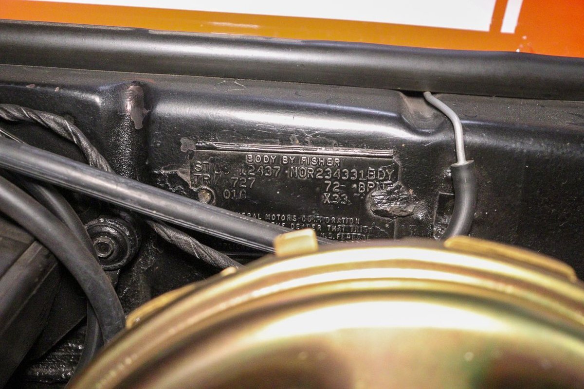

The '69 Z combo everyone wants...orange on white with RS.
What say you about this trim tag?
Link to 1969 Z/28 eBay auction

X66 714 12-24-2022 03:09 PM
Black Vinyl top is gone which means it had black stripes from the factory...Joe

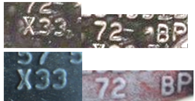

You be the judge.

Jonesy 12-24-2022 05:03 PM
Thats a reproduction cowl tag by the way.
