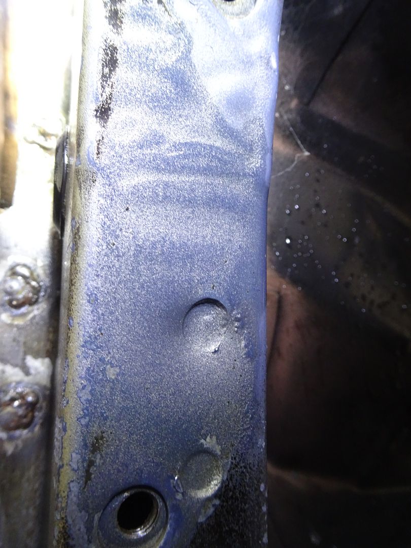

Blue under the axle bump stop, I believe I am the first person to remove. Gold overspray on top of the blue.

Runs of blue in the left torque box with gold overspray on top.

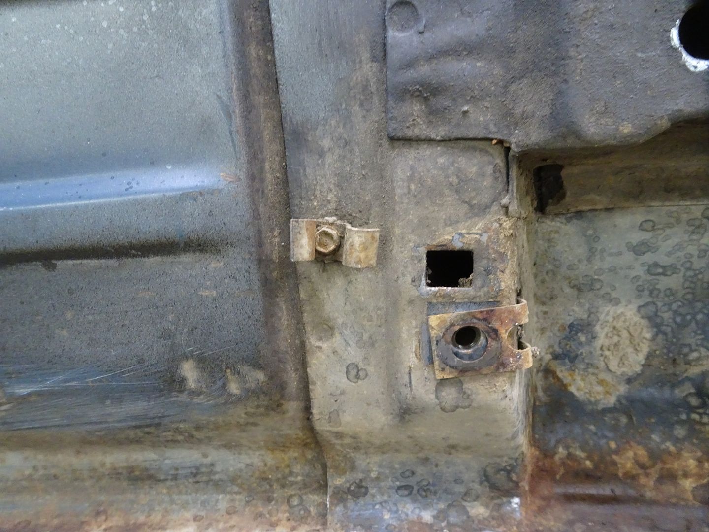

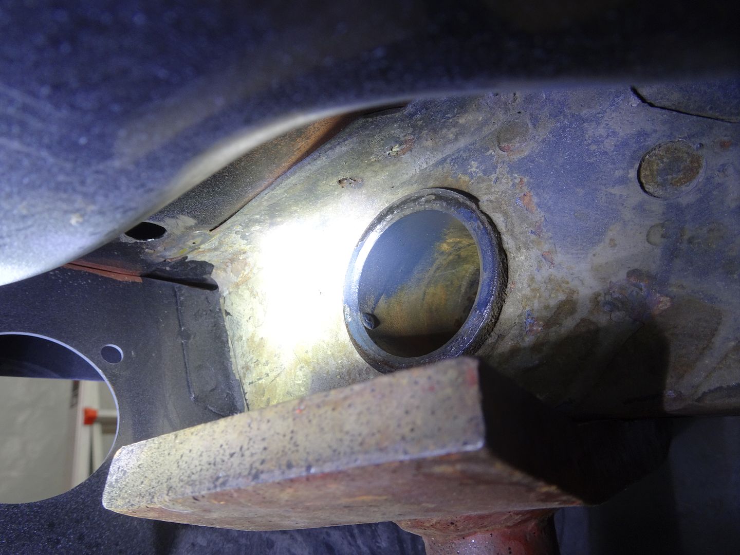

Inside the shackle bushing tube. Bushings are original.
https://www.yenko.net/forum/cache.ph...2FDSC00903.JPG

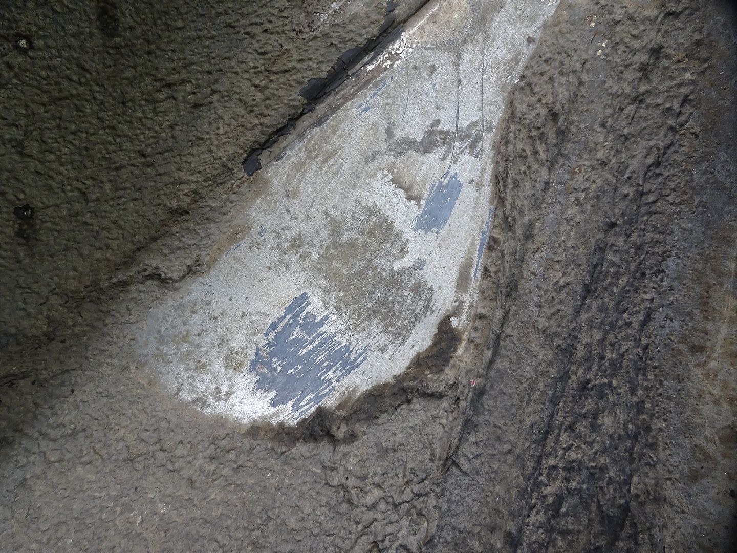

Under the original undercoating near the left rear wheel well.
https://www.yenko.net/forum/cache.ph...2FDSC00902.JPG

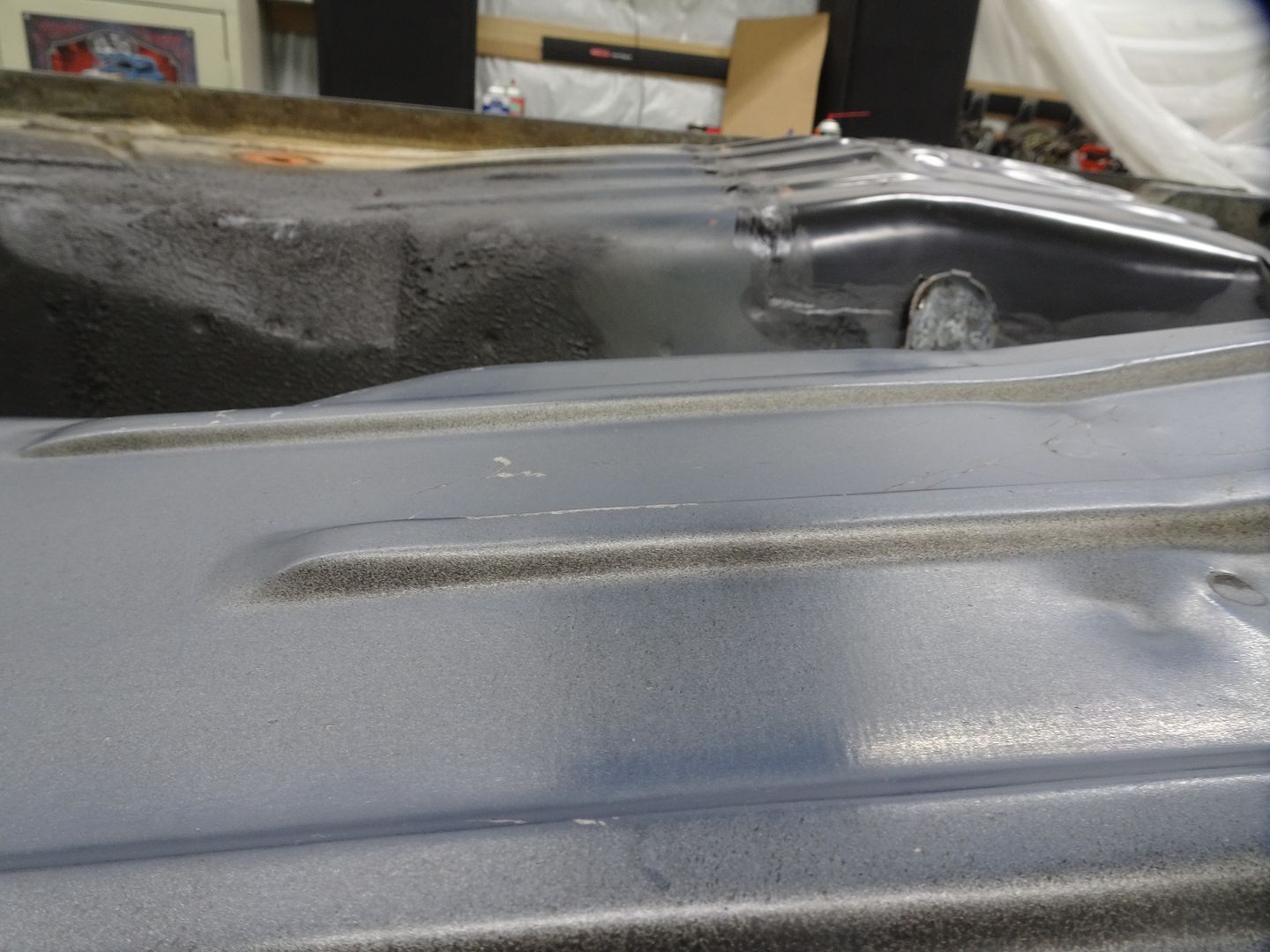

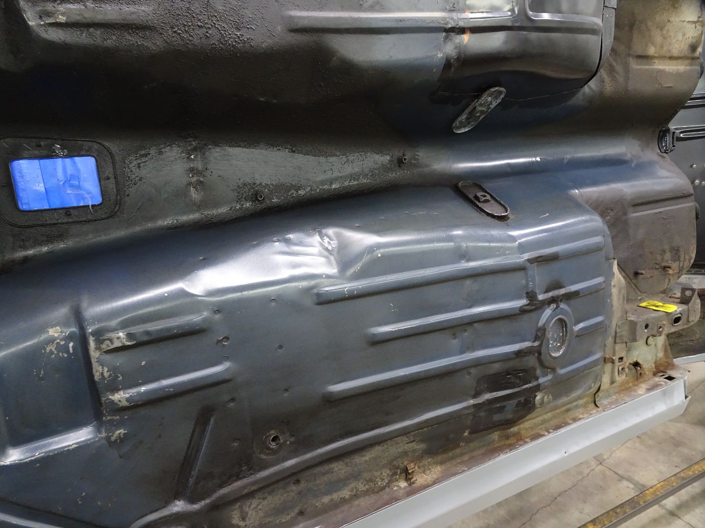

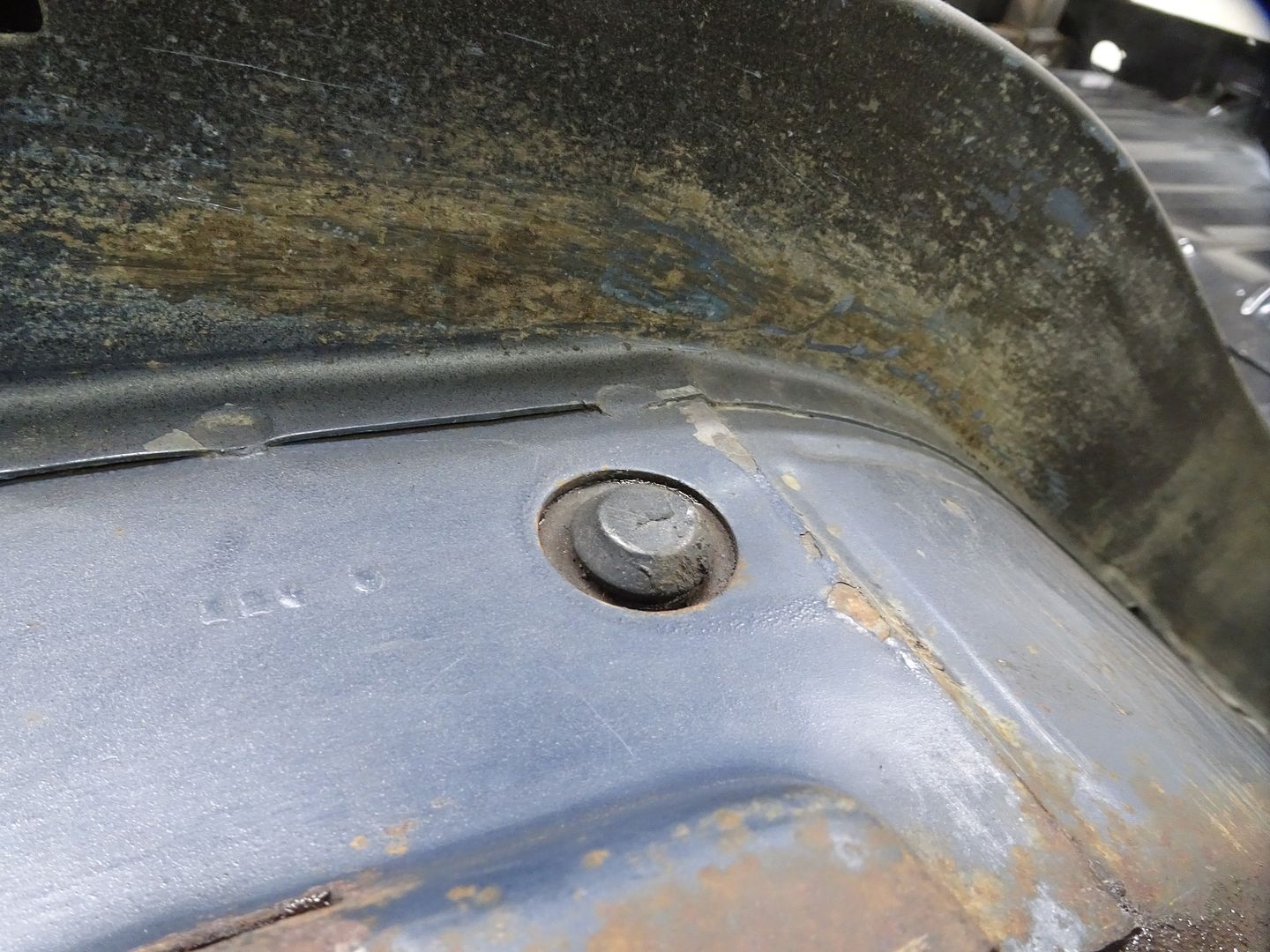

Too Many Projects 04-06-2024 02:35 PM

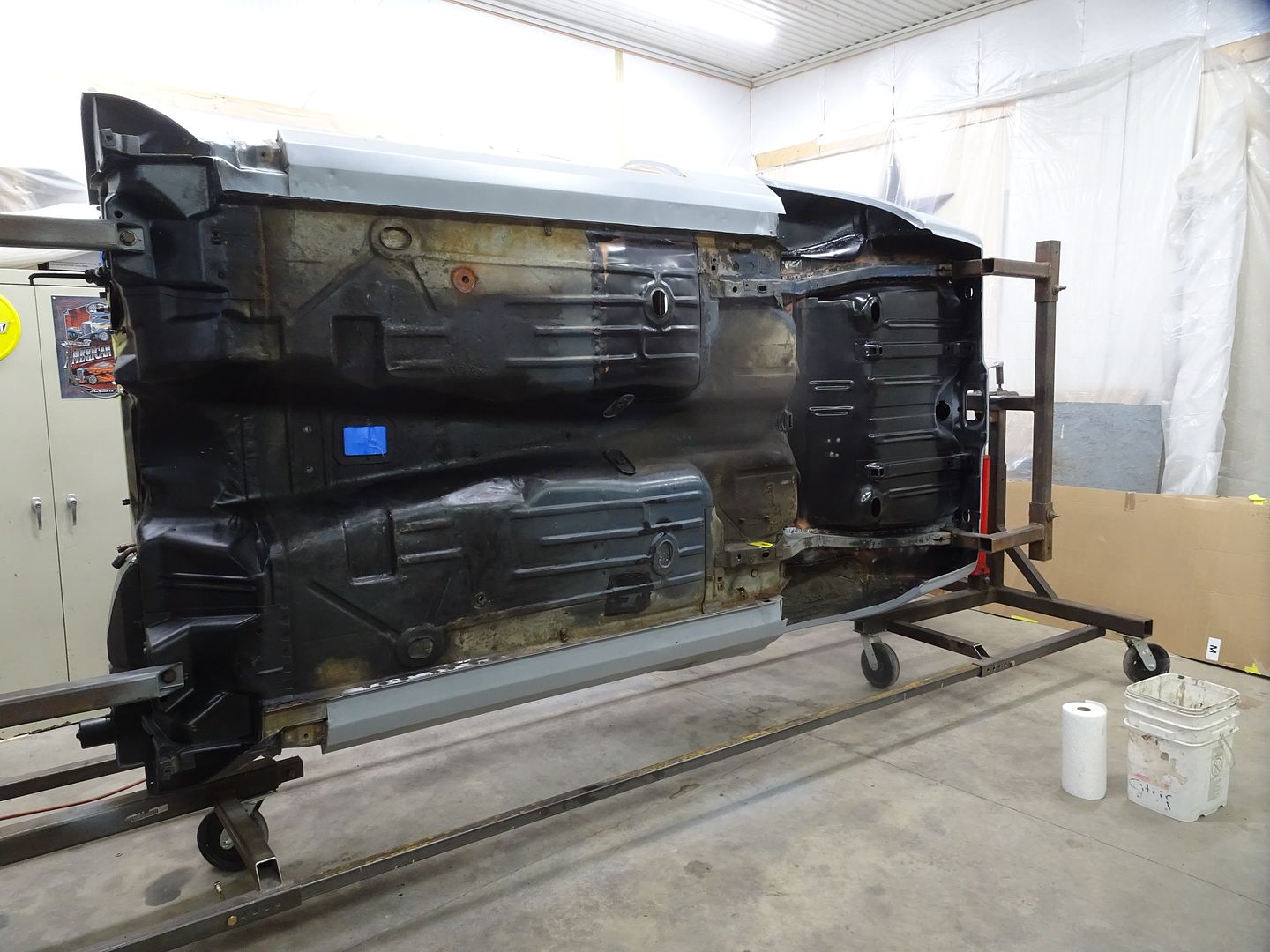

After attempting to clean the greasy mess of the underside on a creeper, I gave in, pulled the subframe intact and put the body on the rotisserie.
This blue/gray color is everywhere under here and I'd really like to know if this is factory original. It certainly seems to be to me, as it is under every piece that is attached after it was applied. With the crusty, rusty, neglected condition the car was in when I got it, it is hard to believe someone took the time/effort to strip this floor to bare metal and repaint it at some time in the past. If that is what took place here, the incomplete application and uneven coverage would not fit with such an in depth restoration/modification. It is a LOS built car in the 3rd week of Feb. The Mountain Green Z28 that Jon found, and was at MCACN last fall, has a similar application of bluish paint also, but not nearly as much. That car is unmolested and has been judged. How was the blue paint on that car regarded as far as originality ?

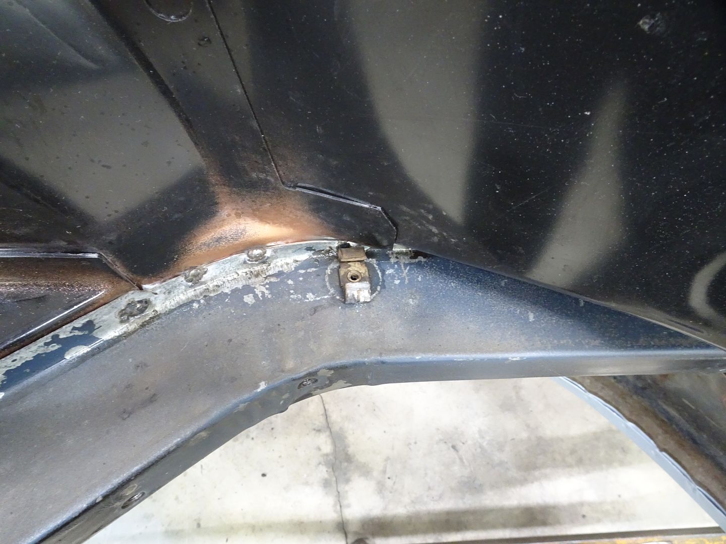

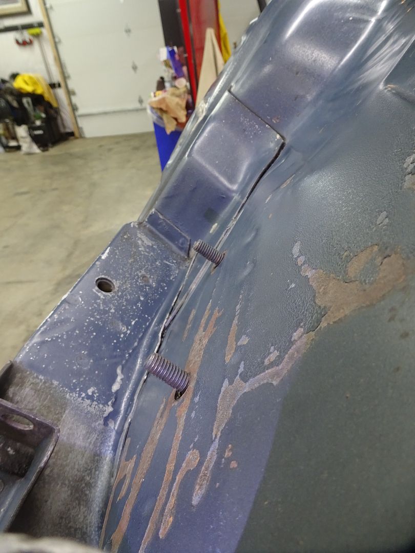

The previous pics were taken with a light under the car and do not reflect the color accurately. This next set are with the body rolled over and lit by led ceiling lighting. The pics still don't look 100% the same to me, as looking at the floor in person, but much closer than previously.
https://www.yenko.net/forum/cache.ph...yNznu2u3kf.JPG
All I have used to clean/de-grease is Simple Green.
https://www.yenko.net/forum/cache.ph...ShPDQ7K6eR.JPG
https://www.yenko.net/forum/cache.ph...yYSwdmJZwm.JPG

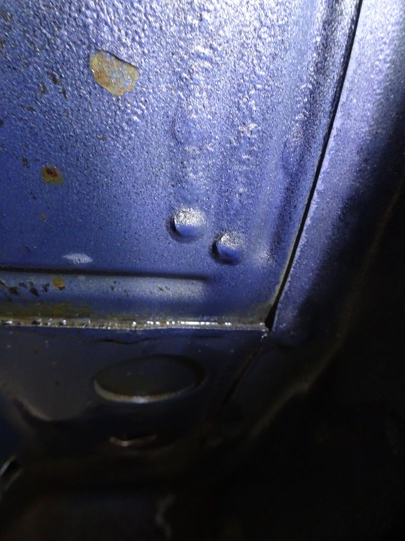

Unlike the Z, the drain plugs have paint on them too...
https://www.yenko.net/forum/cache.ph...fbVdXg7pfU.JPG

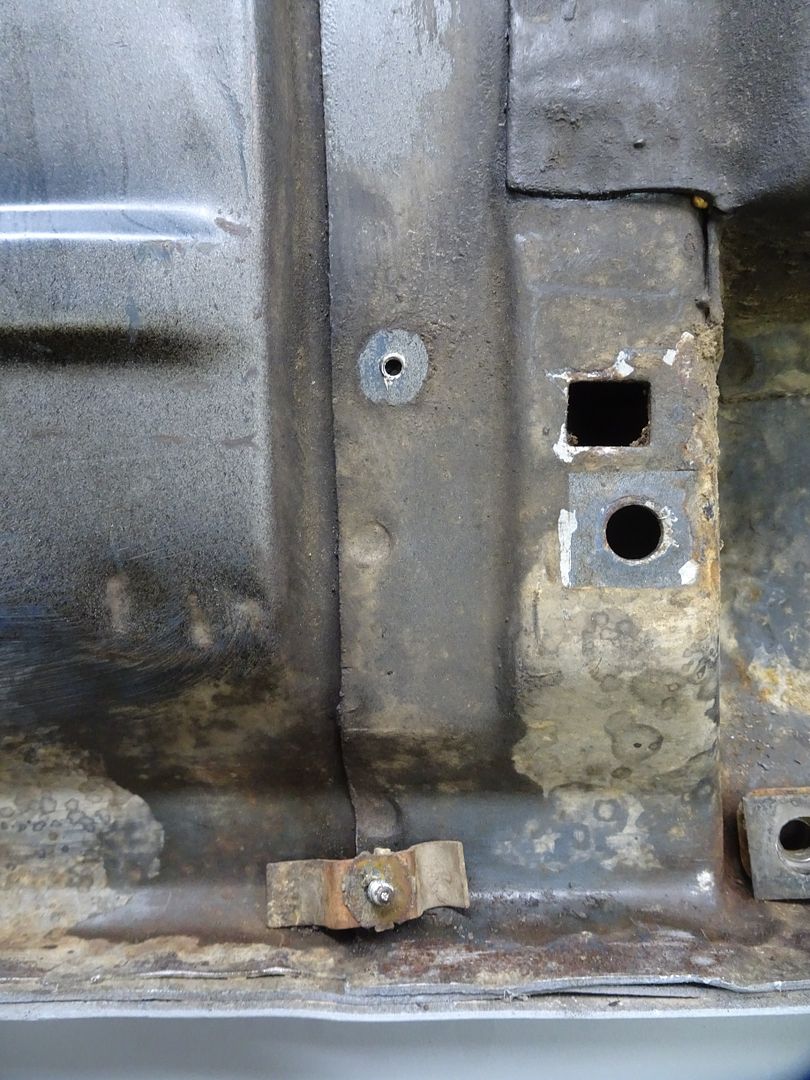

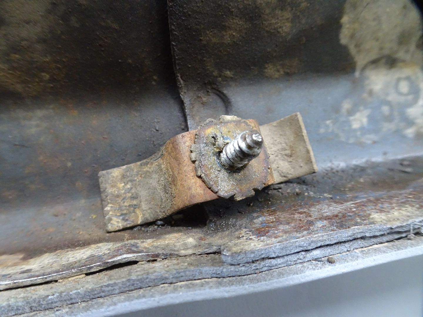

Under the spring cup clip nuts and all the clips for both the fuel and brake lines, but not on the clips.
https://www.yenko.net/forum/cache.ph...2FDSC00925.JPG
https://www.yenko.net/forum/cache.ph...2FDSC00923.JPG

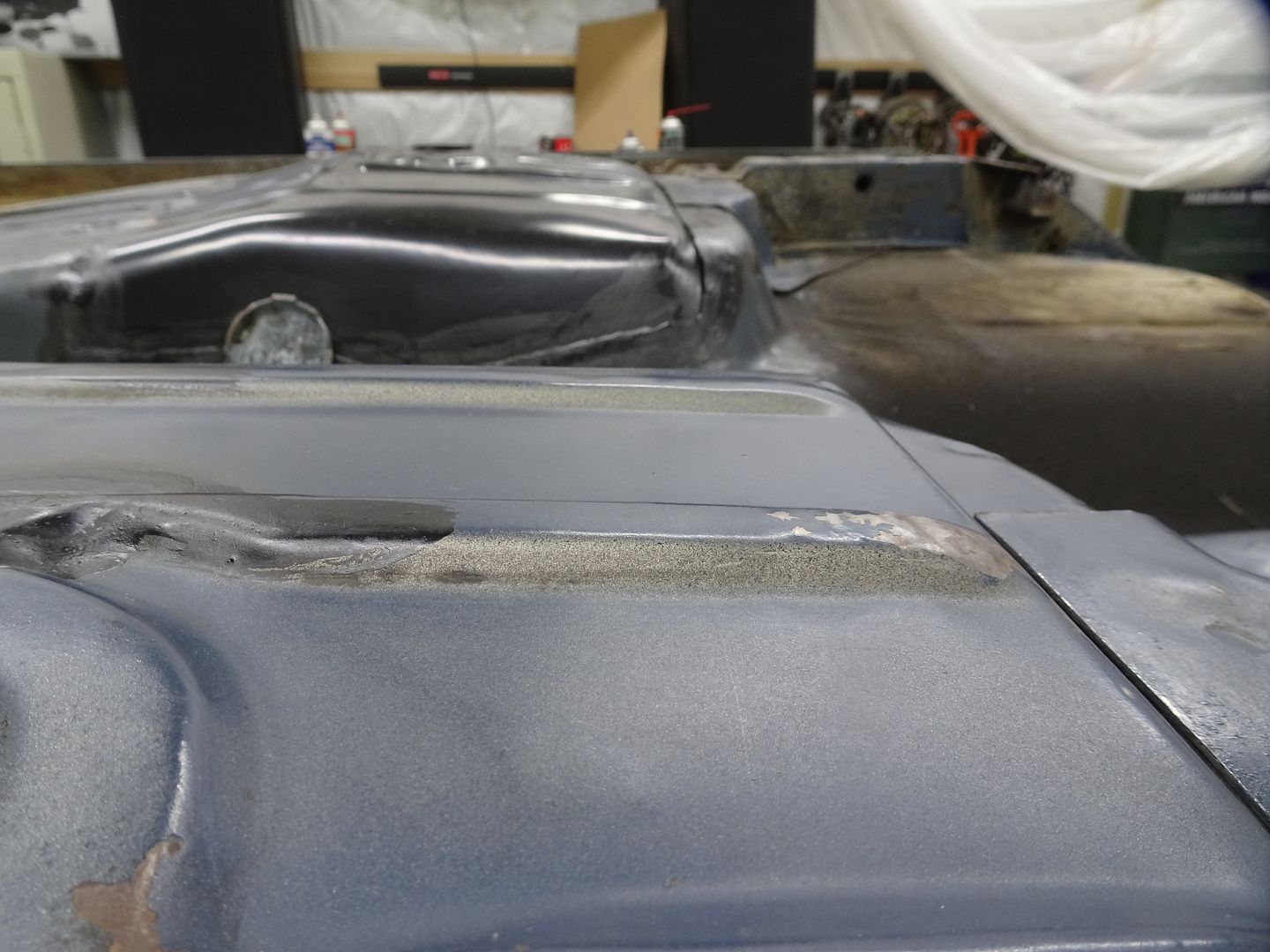

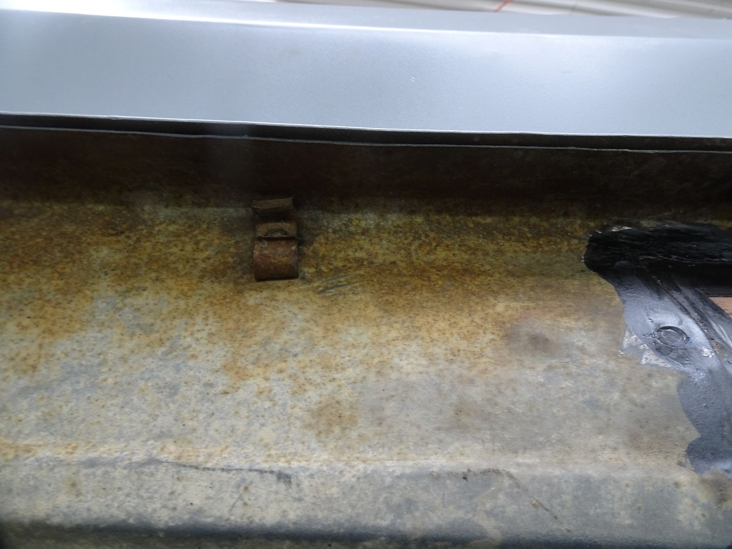

The paint appears to have been sprayed from the center tunnel outward as it gets thinner towards the rockers to the extent that it is barely discernible there and the floor has light rust.
https://www.yenko.net/forum/cache.ph...2FDSC00931.JPG

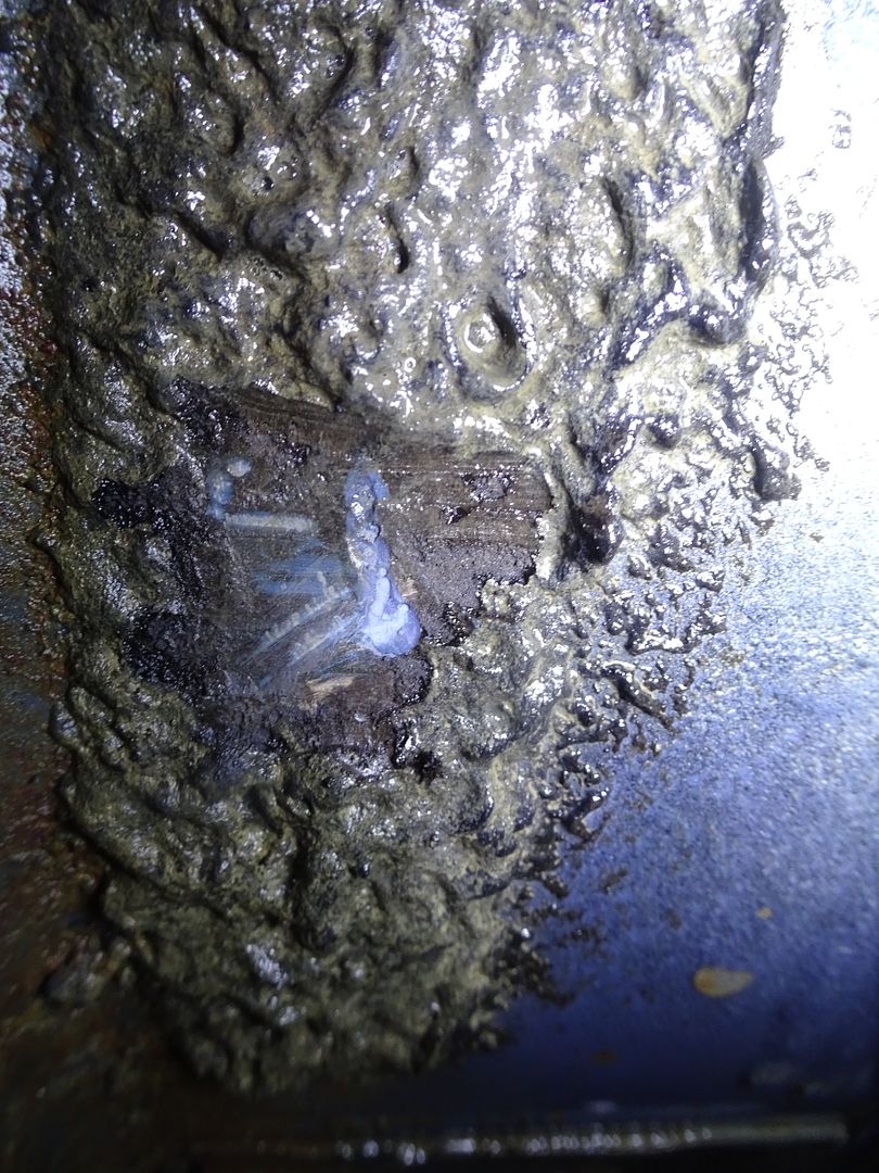

This fuel line clip has some sort of sealing washer under it.
https://www.yenko.net/forum/cache.ph...2FDSC00935.JPG
https://www.yenko.net/forum/cache.ph...2FDSC00934.JPG

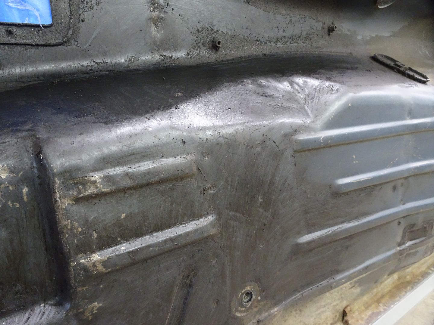

Traction bar plate studs
https://www.yenko.net/forum/cache.ph...2FDSC00936.JPG
Applied from the center out...
https://www.yenko.net/forum/cache.ph...2FDSC00937.JPG
https://www.yenko.net/forum/cache.ph...2FDSC00940.JPG
https://www.yenko.net/forum/cache.ph...2FDSC00938.JPG

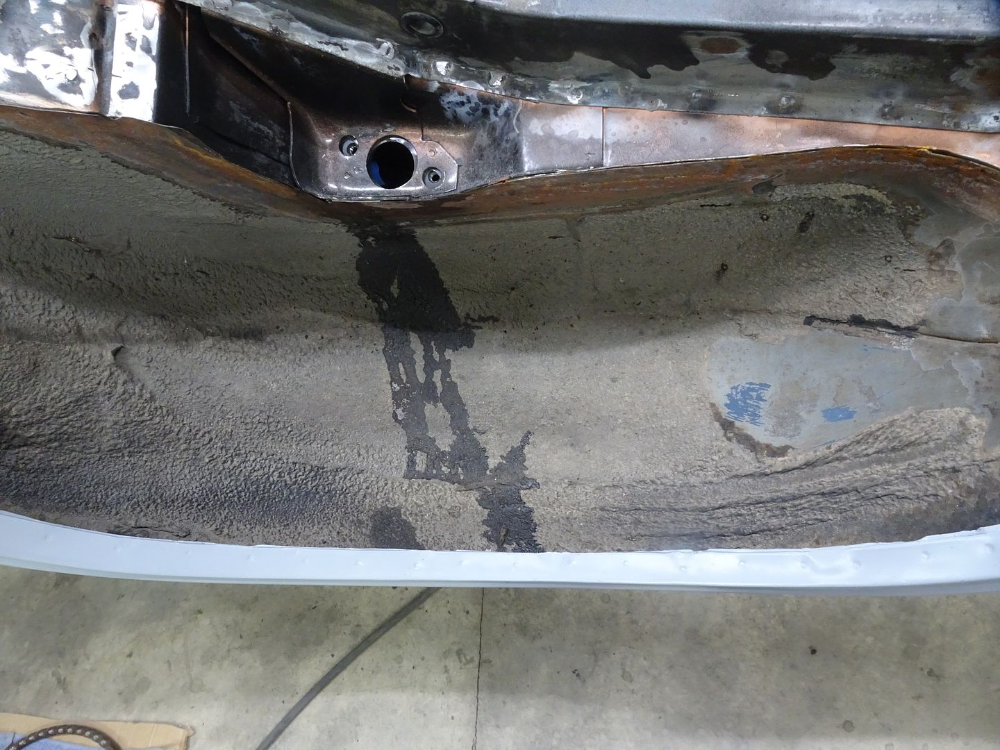

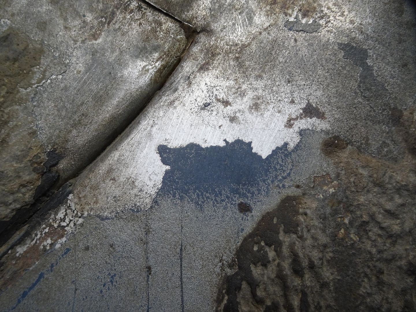

I finished cleaning the grease and oil off today and started scrapping the factory undercoating out of the right wheel well. I was being careful to only take the undercoating off and leave any evidence of blue and I stopped scrapping when I saw, what I at first thought was, bare metal and moved the scrapper to the next area. After a bit longer, my scrapper went thru this color and there is the blue primer ! I then saw where I had scrapped to bare metal a few years ago, when installing the trunk floor. I cleaned the edge of the primer with scotch brite to enhance the 3, distinct, colors of bare metal, blue primer and, what is now more evident, Gold overspray on top of that and the undercoating OVER all of that, just like it should be from the factory....:wink:
https://www.yenko.net/forum/cache.ph...2FDSC00946.JPG
https://www.yenko.net/forum/cache.ph...2FDSC00947.JPG
https://www.yenko.net/forum/cache.ph...2FDSC00949.JPG
