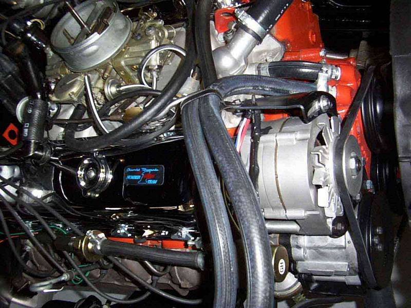

Thanks - I think it's a K. And maybe the covers on the LS5 were the exact same part anyway? I found a pic of an L78 restoration which shows a short straight breather hose on a cowl car - whether that was correct or not.
Dempsey 06-24-2024 03:51 PM
1 Attachment(s)
Pic attached...Attachment 263415
WILMASBOYL78 06-24-2024 05:10 PM
Breather Hose...
That photo tells the story...the spacer on top of the carb raises the level of the air cleaner so that a straight hose is correct. There was no cowl hood on the Nova...your valve covers are a Chevelle item and definitely one with a cowl hood.
Covers for LS5-6 were the same as far as I know...
Mr70 06-24-2024 07:14 PM
Notice the TCS clip and slightly indented Drivers side rear,those valve covers came on on all 1970 Super Sport Chevelles & Elcaminos equipped with an L-34,LS-5,L-78 or LS-6 engine.
A ZL-2 Cowl induction hood had nothing to do with these.
Dempsey 06-24-2024 10:16 PM
Thanks - I suspected the covers themselves might be the same part or part number for all of them, as you say. However it looks like this particular set was "born on" an L-78 with Cowl, due to the yellow decal and the straight hose. That's what I was trying to figure out - appreciate the help on that!!
