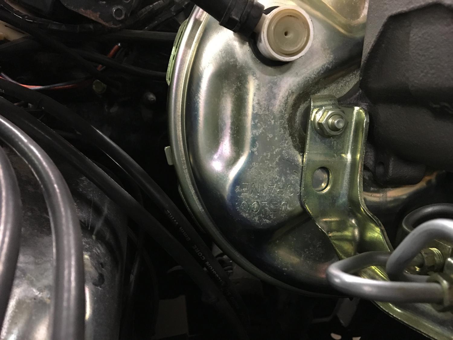

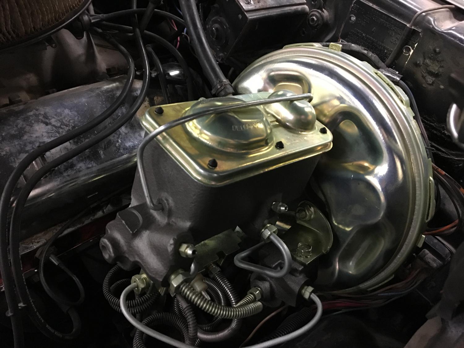

L78_Nova 04-16-2025 01:13 PM
70 Nova Brakes
2 Attachment(s)
Found these from my March 70 SS 396 L78 car.
Attachment 281472
Attachment 281473
Gary

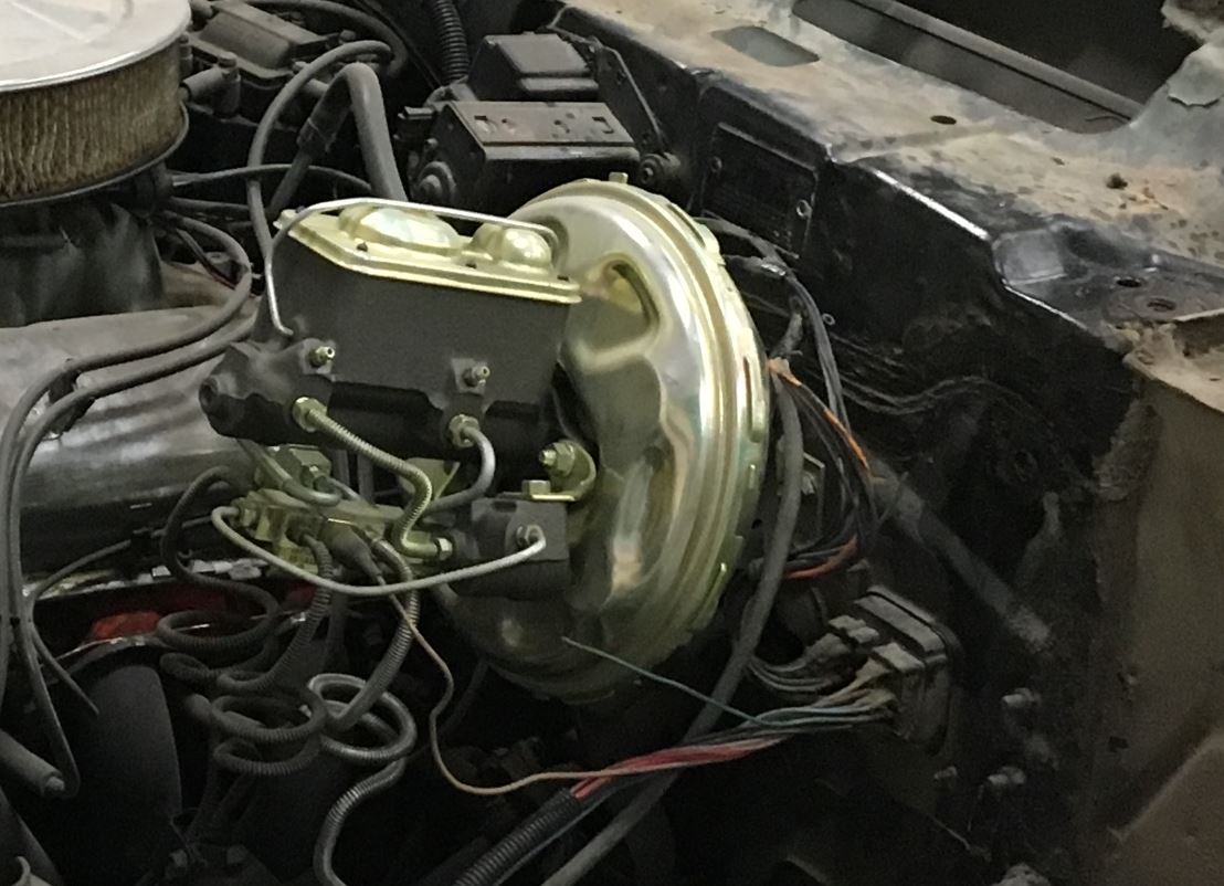

L78_Nova 04-16-2025 01:16 PM
Nova Brakes
1 Attachment(s)
Attachment 281474
One more.
Gary

FX6970 04-17-2025 01:09 PM
Hi,
Gary,thank you for the photos:)
Chuck,I will be sending you an email.
Thank you,
Tony
