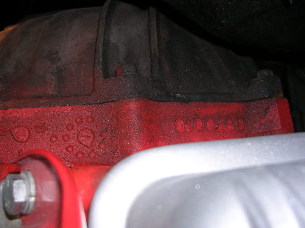

47Hammer 09-28-2006 10:05 PM
Need help w/Block casting #'s
These numbers are on the rear of the block and i'm not sure what they stand for, any thoughts?

Hotrodpaul 09-28-2006 10:14 PM
Re: Need help w/Block casting #'s
3970010 - Block Casting Number (2 or 4 bolt design 4" bore, 302 or 350 usage, late 69 thru 70's)
I 23 70 - Casting Date Code (Sep 23rd 1970 I think)
Paul
47Hammer 09-28-2006 10:18 PM
If that's correct the block in my car is not the right date because the P-O-P reads V0323CTB. https://www.yenko.net/ubbthreads/images/graemlins/no.gif
YENKO DEUCE REGISTRY 09-28-2006 10:45 PM
The 010 block is correct, and the location of the date code is correct as well. I'm not sure it's decoded as Sept of '70 though, wouldn't that date be for a '71Z - assuming this block is the original block? The POP lists the engine assy date, not the cast date.
47Hammer 09-28-2006 10:52 PM
The trim tag shows 04A build date.

Mr70 09-29-2006 04:29 AM
I think that's the letter B,not the letter I.
Which would all make sense.
Block cast B-(February) 23rd,1970.
LT-1 Engine assembled at Flint 3-(March) 23rd,1970.
Z/28 Camaro w/4spd assembled 4-(April),A-(1st week),1970 at Van Nuys plant.
47Hammer 09-29-2006 05:21 AM
I think your right about the "B" and when I blow it up real big it looks liks another letter and B does make sense. I now believe this car has the original motor in it. What do you guys think?
47Hammer 09-30-2006 02:49 AM
I cleaned it up a bit. Looks like a B or D ?

Jonesy 09-30-2006 08:36 AM
To me, it looks like someone ground off the letter and the end number.
L78steve 10-01-2006 06:37 AM
Check the pad in front of #2 cyl.behind alternator to solve your mystery.
