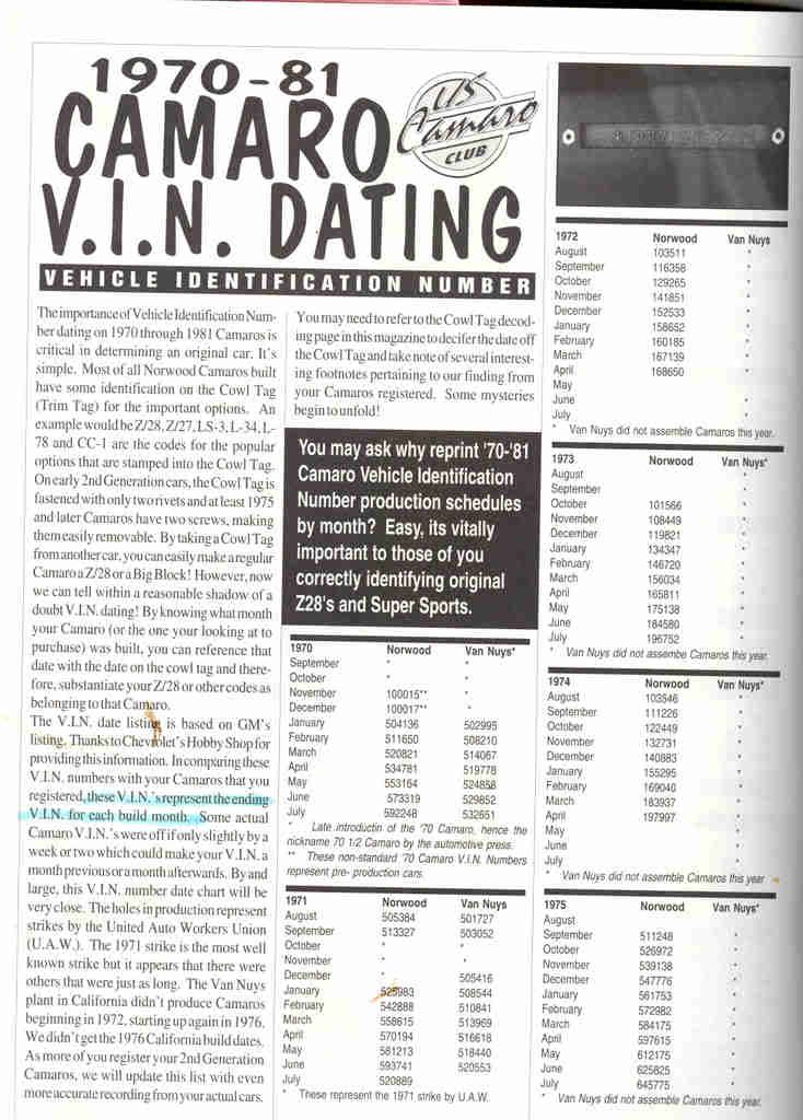

Could someone tell me the begin/end VIN range for a '70 camaro with a trim tag build date of 03A? Where can I find this info.?

Norwood or LA Built Camaro?

I have an 03B LA built Z-28, VIN 124870L510574.
Paul
Norwood (124870N514702)
CamarosRus 11-27-2006 10:24 PM
Re: VIN/trim tag build date
http://img.photobucket.com/albums/v4...amaroVIN-1.jpg
Hope you can increase size to make more readable as I am having trouble doing so........

now that's service! https://www.yenko.net/ubbthreads/imag...iggthumpup.gif
JHS 11-28-2006 12:28 AM
Ditto..., thanks!
