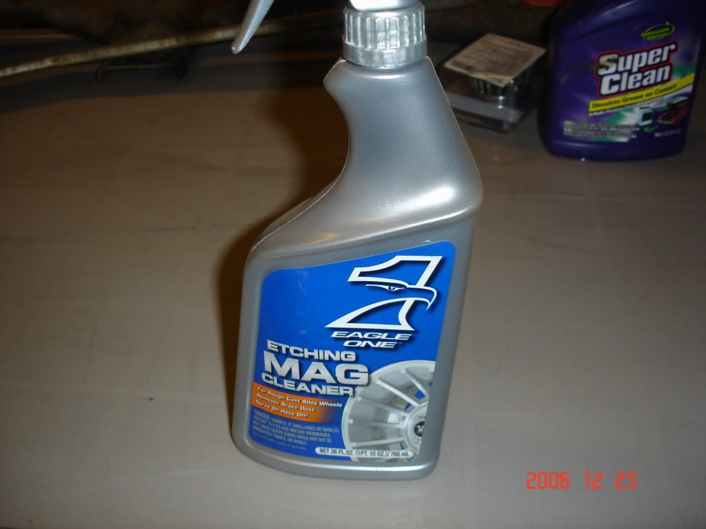

Fred........After Glass Beading........Use this.....Follow the Directions and you'll probably have to do a couple of applications to "Even" out the finish and eliminate any streaking
http://i13.photobucket.com/albums/a2...z/DSC03772.jpg
and then it will turn out like this
http://i13.photobucket.com/albums/a2...t/DSC04399.jpg
Ken

I'm a big fan of the Eagle 1 stuff. I used it on an old GM dual quad intake without blasting it and had almost the same results. https://www.yenko.net/ubbthreads/imag...iggthumpup.gif
