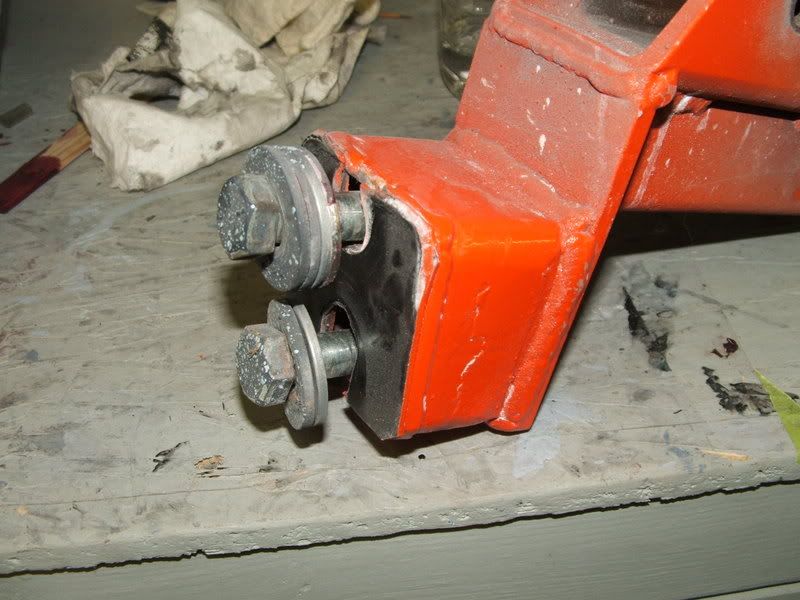

Hope these photos can help. I made my own for a 69 Camaro. Attach to the bumper bracket mounts, plenty strong there. On the Camaro one I glued on a 1/16 " rubber pad.
http://i18.photobucket.com/albums/b1...POPaint023.jpg
http://i18.photobucket.com/albums/b1...e/mount004.jpg
http://i18.photobucket.com/albums/b1...e/mount005.jpg
And one for a 69 Nova
http://i18.photobucket.com/albums/b1...e/mount002.jpg
Mike A
