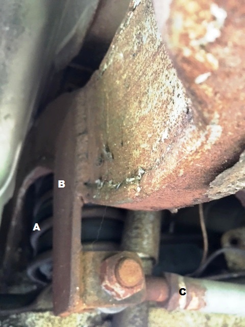

Default underside
picture1) Ball joint extensions. Pic2) A-relocated fuel line, now, 1/2 in. B-drain cock front edge of tank, C-driveshaft loop,D-Watts link on rear of 3rd member pumpkin. Pic3) A&B-boxed trailing arms w/ steel bushings. C-watts link LH arm. Pic4) A-Airlift bag, B-Watts link mount on sectioned frame. Pic5) A-looking inline with axle tube, top of pumpkin, pinion angle turnbuckle B-hoses to trunk mounted Bendix fuel pumps. Below clamp is Watts link pivot on pumpkin and partial view of rod.
