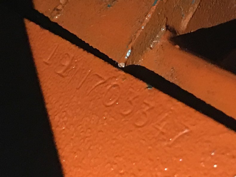

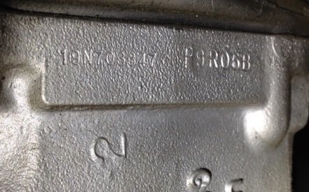

Does anyone know this car? It's on eBay.

There a lot of things wrong with that car to ask 99k for it...Joe

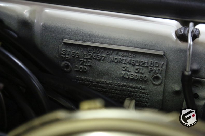

Has a repop cowl tag on it for one.
124379N703347
RUN AWAY!!

Not to mention all the other questionable stampings etc.

Look a little different

I have never seen a block stamp that clear....
Bill

I don't like the trans stamp either!
Buddy

Is it just me or is that some funky paint because it sure don't look like Dusk Blue?
Lots wrong with it.
