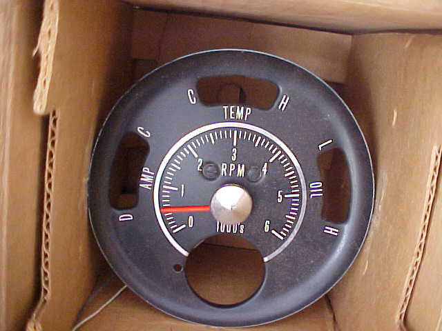

Default DOES ANYONE KNOW THIS TACHOMETER ????
I HAVE THIS AC DELCO FACTORY TACH CLUSTER..ITS NOS AND I HAVENT A CLUE..COULD BE BUICK,OLDSMOBILE OR PONTIAC???..THANKS FOR YOUR TIME....MIKE.

Default Re: DOES ANYONE KNOW THIS TACHOMETER ????
Mike, Olds 442 1967? Just a guess
Whew...Matt..that was quick...I'll check it out..Mike.
