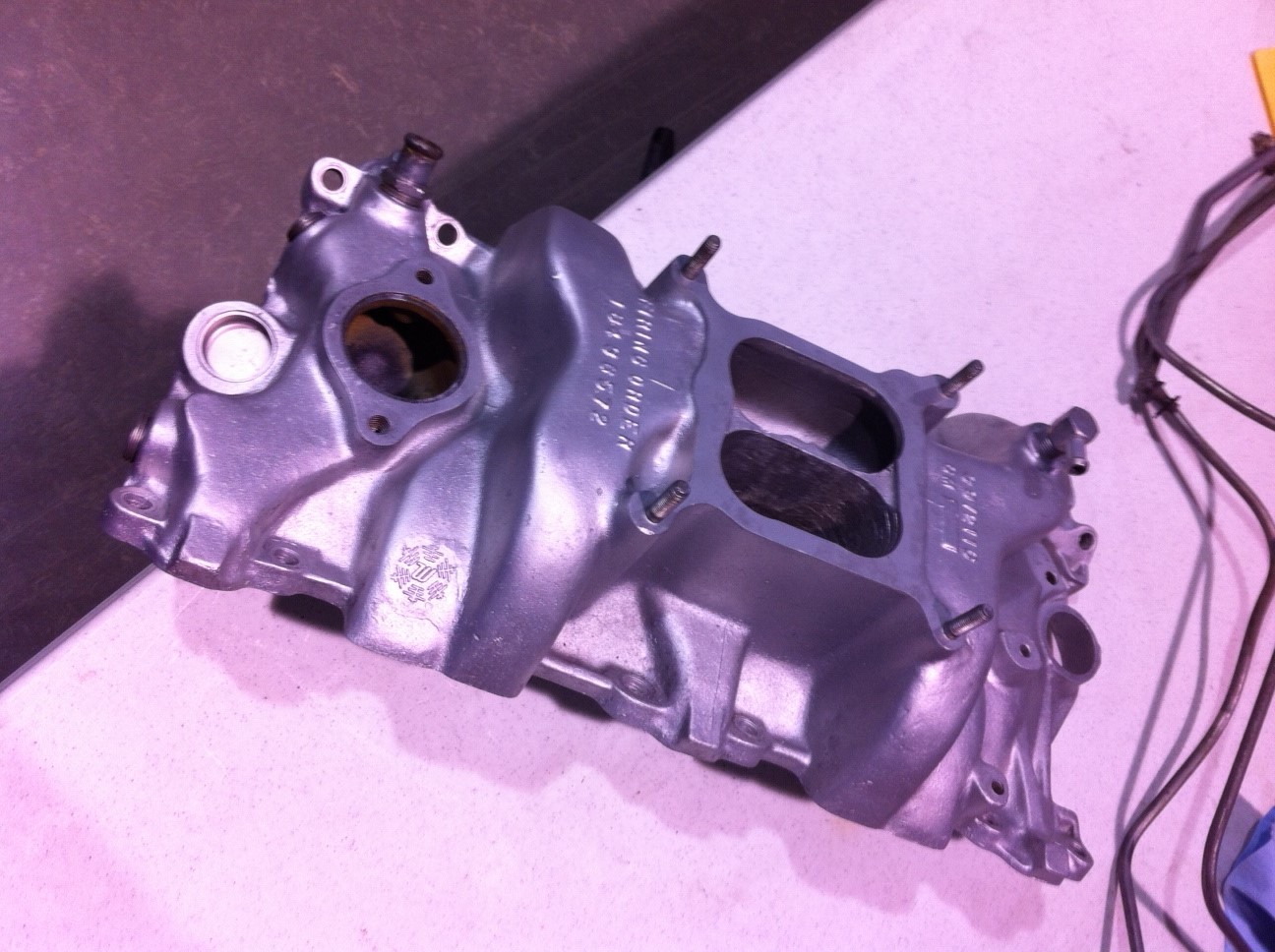

Does anyone know what this intake is off of? Looks like a 472 intake but there is no casting number. The rest of it looks good to me but thinking it had to have been a LT-1 intake to have the snowflake but no part number or perhaps a GM parts intake sold over the counter?
Thinking of tumbling it and using it but would like to know what it is?

It’s a early issue 1971 Z28, with the cast over oil fill tube hole, late 71 and 72 up had the cylinder numbers on runners. Take bottom shield off to check date, that will tell you.

Thanks Mike. I'll take the splash shield off when I have it tumbled next week. Much appreciated.

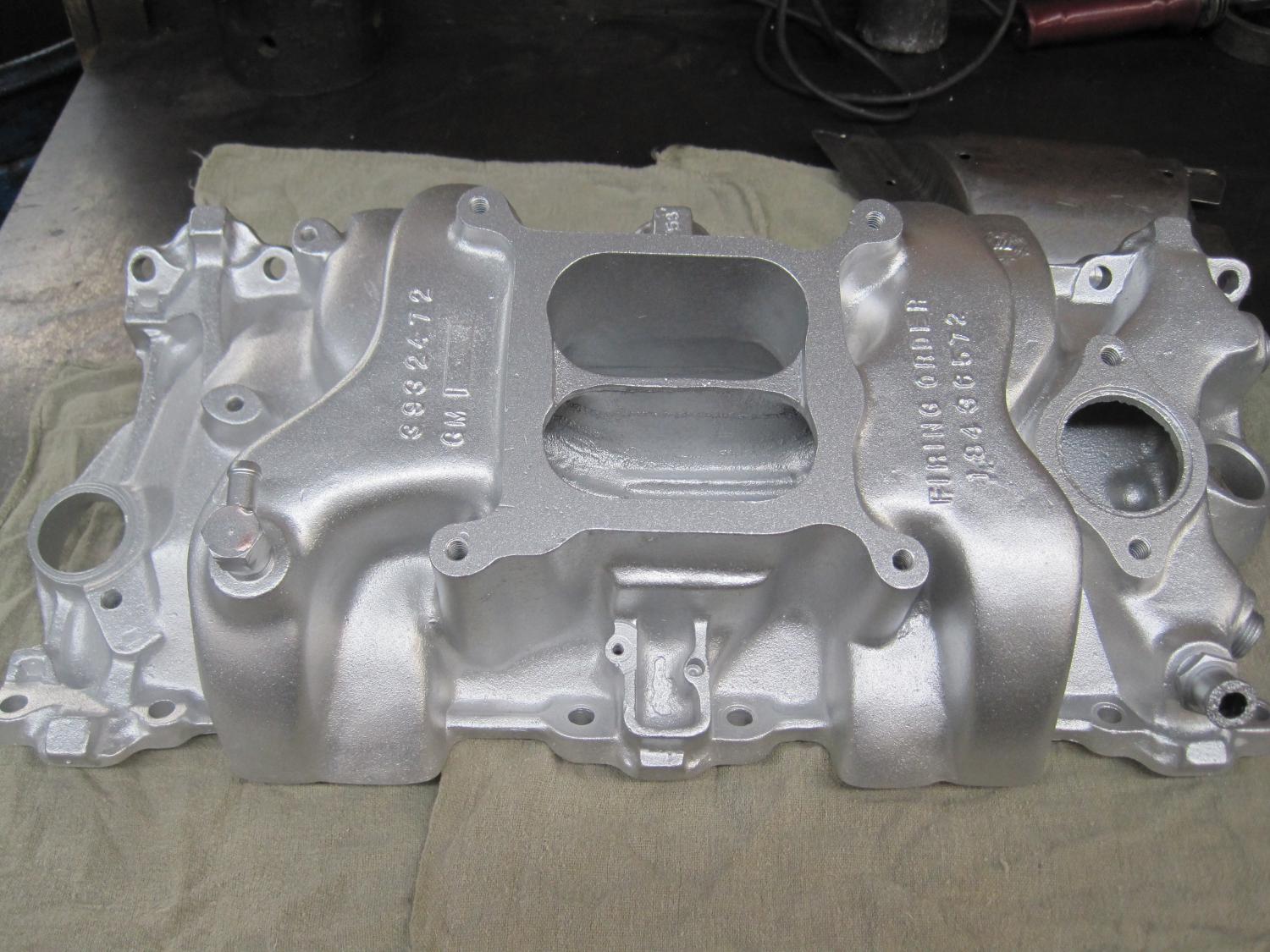

This is one of my tumbled manifolds.
