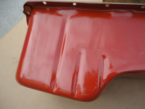

I'll see if I can dif up pics. The later pans had a larger radius opening for front seal and only two step drop. The orig had the smaller radius and three steps drop. Pictures are really needed to show the points I'm trying to make.

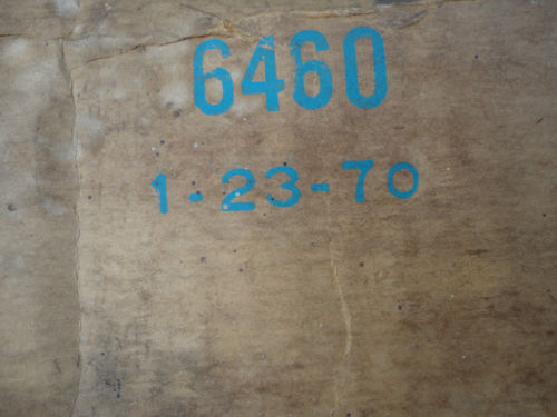

Here's some nice pix I saved recently.Notice the date on the box.

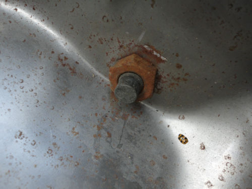

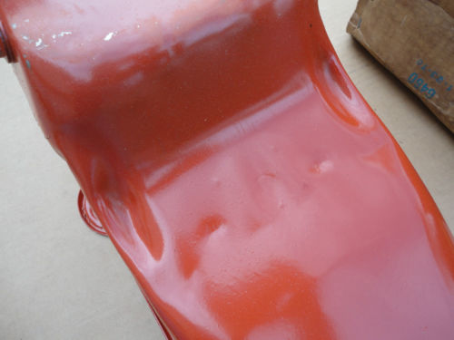

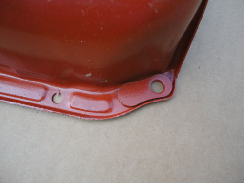

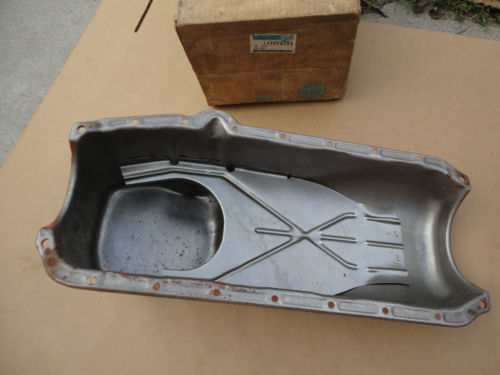

More..
