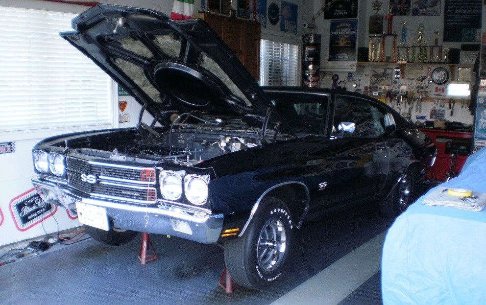

Hey guys tonight i sold my 454 NOM that is running in my Chevelle.
Over the Winter i will be rebuilding my original LS6 that will go back in when it is finished.
I will be needing your advice on what is the best way of taking out a motor with a M22 four speed attached to it.
It has been almost 20 years since i last did this and my muscles and bones are not what they used to be like so i am looking for the easiest method to go about taking a motor out.
I would like to know if it is best to take the motor out with the trans attached or un bolt the bellhousing and leave the tranny were it is.
The Transmission does not need any work done as it is fine but i would appreciate your advice.
Thanks Danny

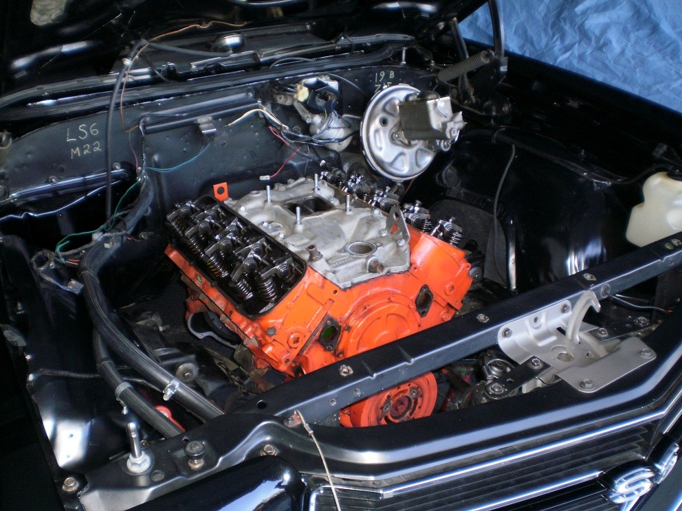

Tomorrow morning i will start with the removal of the Radiator/Hoses/Alternator and Headers.
Here is what the motor looks like now.
I will post my work for each day as i go along here.
Hopefully i can get a lot done before the Show this weekend [img]<<GRAEMLIN_URL>>/biggthumpup.gif[/img]

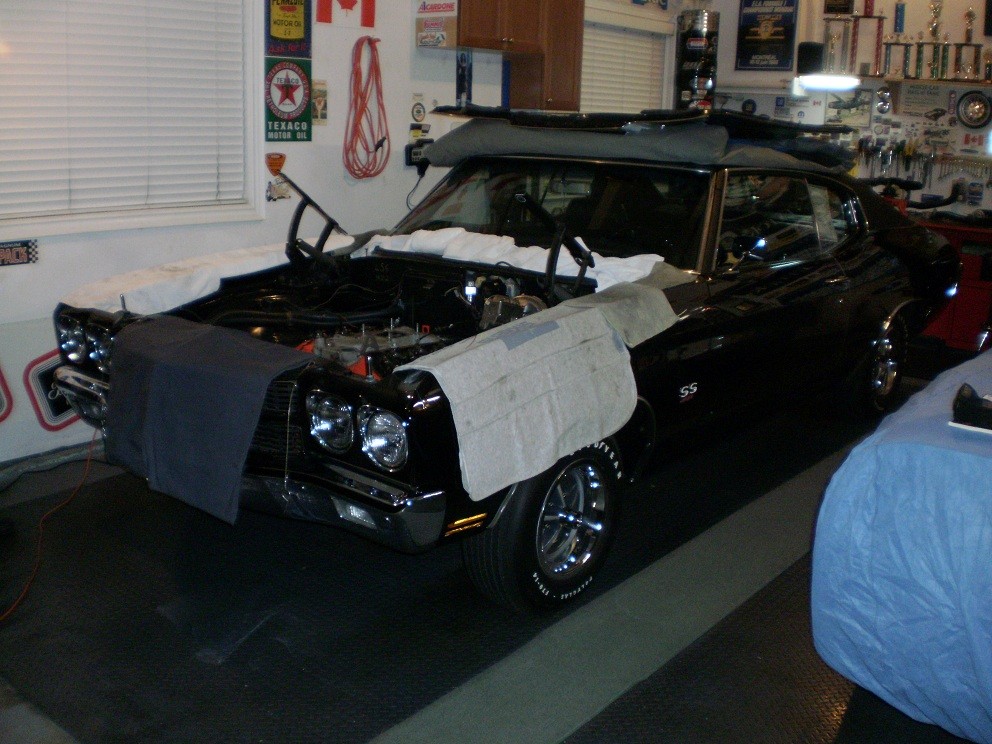

Perhaps this is obvious..but, make sure you protect the fenders, body, etc. with covers and padding. It also a good idea to have a friend help when you pull the motor...that's a lot of weight on the hoist...make sure chains are secured properly...most of all go slow and be safe.

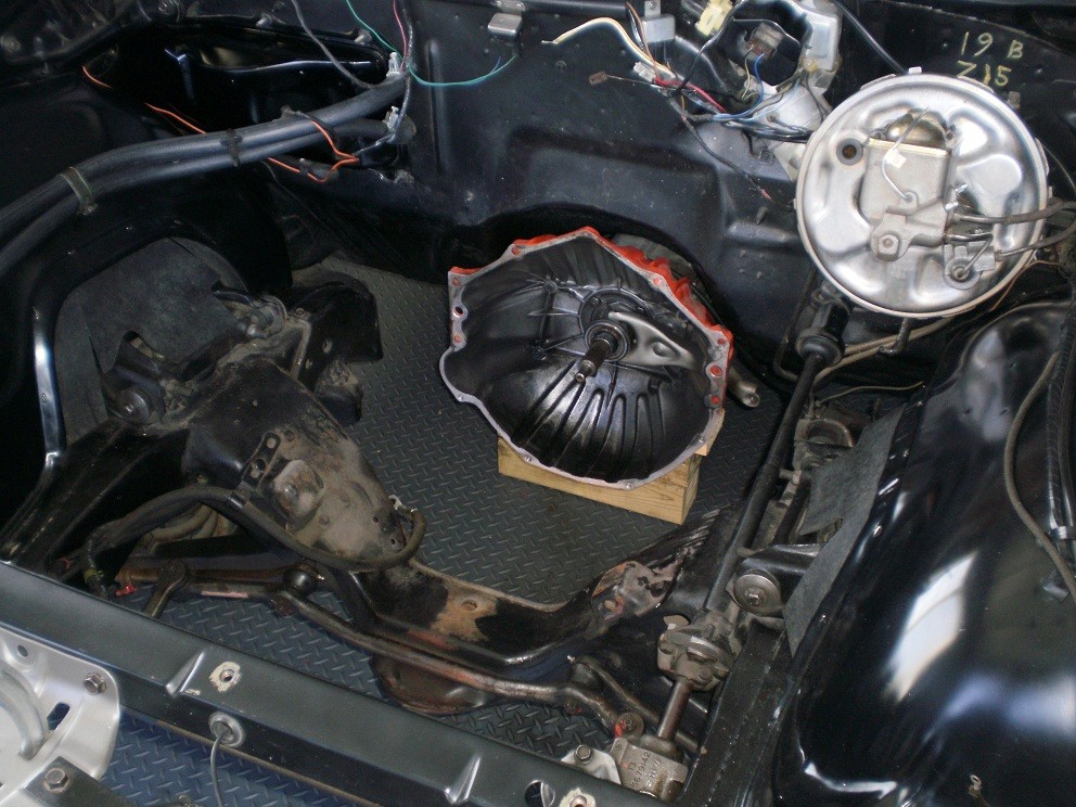

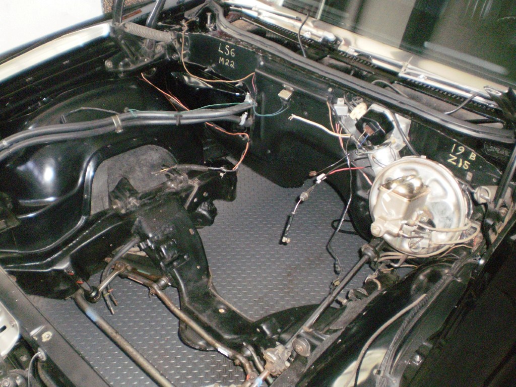

Headers off,Radiator off and all the externals cleared away.
Not bad for a days work.
Only broke one part, the brake boosters plastic vacuum valve.
It was the original but it was so dry and brittel it just cracked in pieces.
Tommorrow i will take the drive shaft off, the rest of the exhaust system, take the hood off if my buddy comes by to help and then start on the Transmission.
Thanks for the tips guys.
Note, the Header is off on the drivers side but i will wait to pull that one while i raise the motor.
Man those headers were a major pain in the Arse. [img]<<GRAEMLIN_URL>>/biggthumpup.gif[/img]

THROW THOSE JACK STANDS AWAY!!!!!!!!!!
Those are the worst jack-stands ever made! Do not go under the car using only those stands.
I burried a good friend because of those pieces of junk.
Get a good set of the 4 leg, cast ones. You will not regret it.
