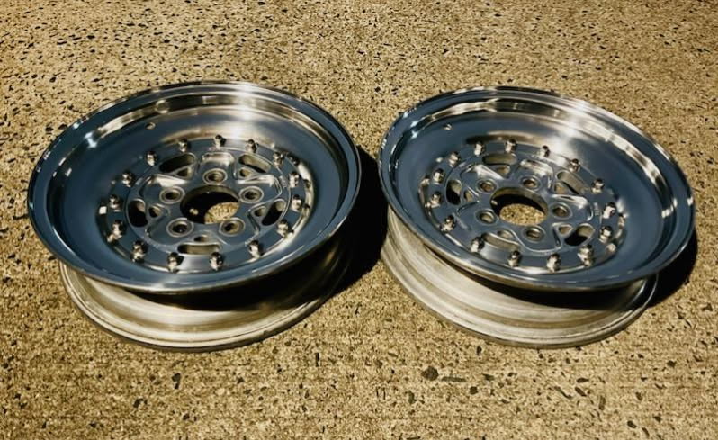

Is a 15x4 skinny with 1 1/2" backspacing enough to use on the front of a 69 Camaro? Looking for a tire that won't give any issues. I would assume the wheel will be more outboard or closer to the fender edge. Thanks guys.

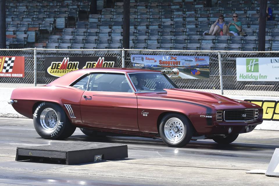

Radials look awful on 4 inch wheels. I've got Firestone 6.40 15 on my Camaro. They are about 27 inches tall.

I love the 6.40-15 Firestones. They look great with an L60 rear.

What backspacing are y'all using? I've read 2" on up. The skinnies I plan on using are 1 1/2" BS. If I go bias ply the tire shouldn't balloon like the radial tire if what I'm reading online is correct. I was informed about the MT Sportsman tires, but not too keen on the roundness of it. I'm thinking this skinny needs a full tread pattern I would think. And I have been looking at a ton of tires for the past week. Anything you guys can point to will be appreciated.

If you are cruising around I'd run a DOT tire of some kind, available in bias or radial.
I have M/T SR fronts, heavy but drive great.

John, what size are the front M/T tires on the yellow 67?
