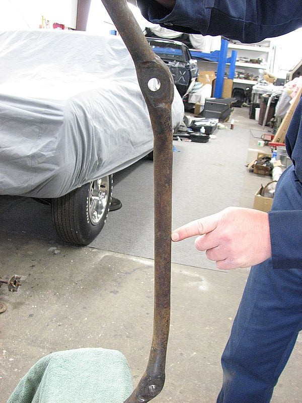

Rick, can you post some before shots of the drag link?

Not the best but here you go.
