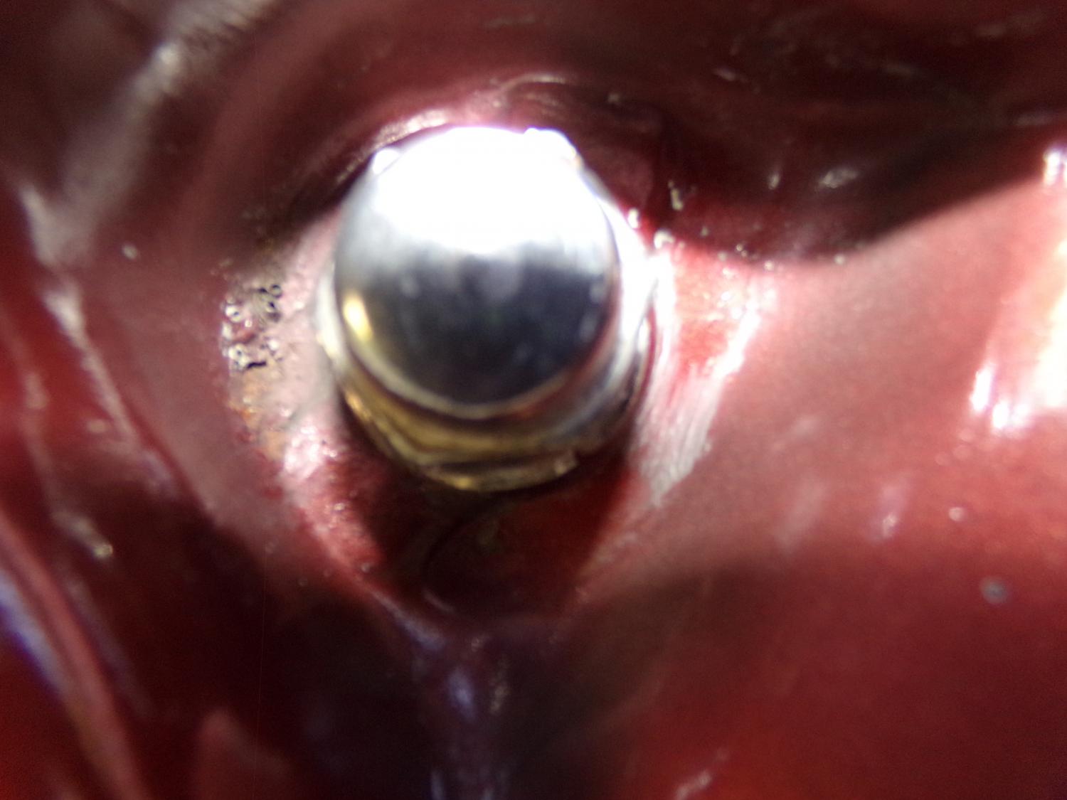

I wanted to post this here so I could get feedback from you guys. When I last had my 1978 Camaro Z28, that I bought new, serviced they marked on the Courtesy Visual Inspection form that the lug nuts (original) were going on too far, going past where they're supposed to stop and would require attention soon. Is this most likely that they are just too old and should be replaced or is this more a wheel problem where the original 5 spoke steel wheels have the wheel stud holes enlarged now where the lug nuts instead of holding the wheel tight are actually being forced into the wheel stud holes too far? I know a buddy with a 1967 Nova SS had to replace his original steel wheels because the wheel stud holes were too large and he was told it was actually a safety factor.

Get a few pics with the nuts on, so we can see how far out the holes have been flared and then with those same nuts off, to see how much space is around the stud. They may just be looking for business or protecting their butt from a lawsuit, IF something were to happen that involved the wheels. Businesses today can't be too careful with that kind of crap. Seems way too many people want to get rich from a frivolous lawsuit.
We all have steel wheels that have been off and on numerous times and they are still good. IF the nut goes past the wheel and bottoms on the drum/disc, THEN the wheel will be loose and could start wobbling and enlarging the holes.

Those factory wheels do require correct lug nuts, I have seen lots of lug nuts wear into and degrade the tapered section on the nut that seats against the wheel. On that note you can probably find after market chrome lug nuts with a 13/16 wrench head size which would have a larger tapered area where the nut contacts the wheel which may help.

I don't think it is a major problem currently as by what I've been able to see just a few, not all, of the lug nuts have a splayed look to the chrome part of them against the wheel. I'll have to look further into it and will try to get some pics posted.

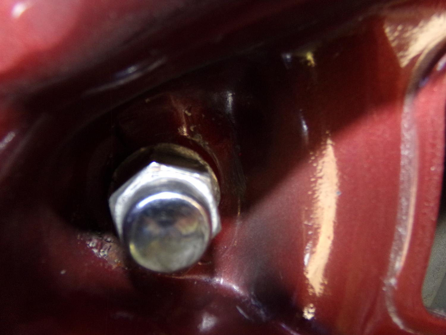

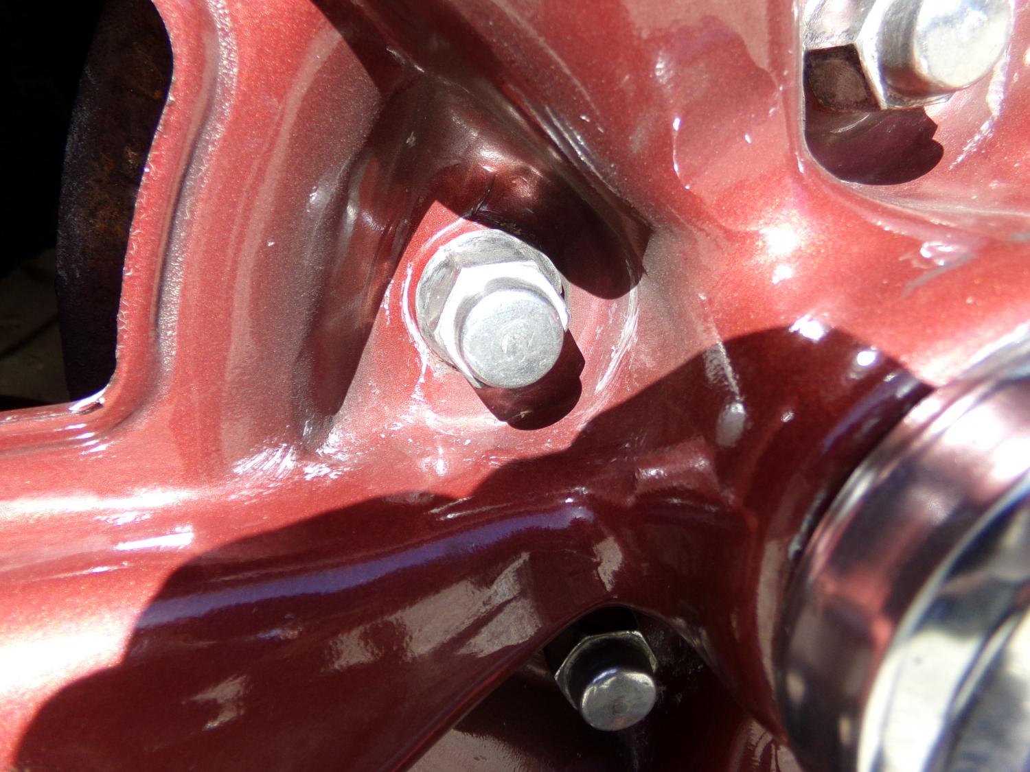

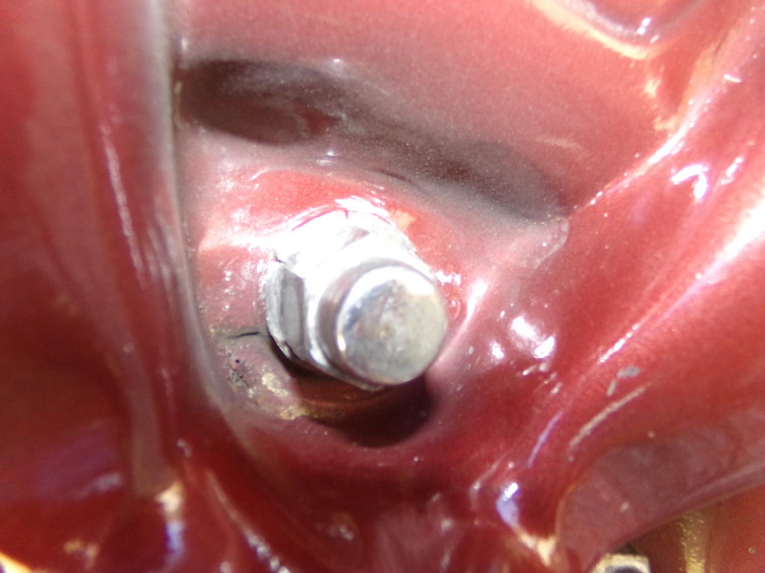

Here are some pics I took showing some of the lug nuts that have that splayed look to them.

...would bulge nuts help here? Just throwing that out there. Cheers.
