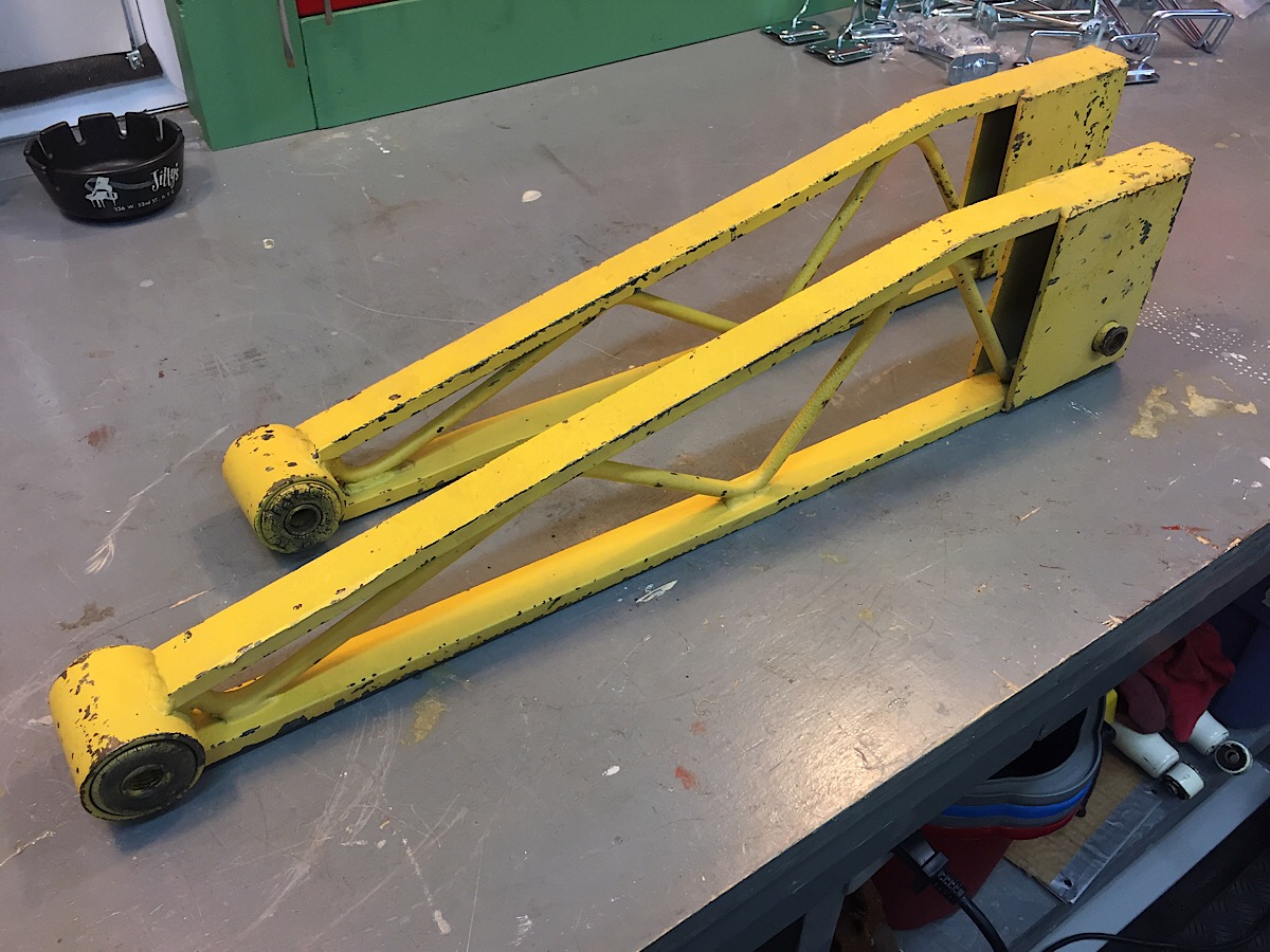

These bars have been for sale for a long time on ebay.
Are these home made or Lakewood MNW other?
Did anyone make a ladder bar like these?
https://www.ebay.com/itm/Vintage-196...temCondition=4
69 442 post bench 3 pedal

check out Sam Griffith's Black 69 Chevelle L78 day-2 build on this site. I believe he has a set of these on his car now.

We have a set of these installed on my sons ‘74 Pontiac - have the “look” of running ladder bars, without any of the “issues”. Pretty neat.

I noticed Sam's Lakewood bars don't have bushings at the axle mount location so they will work better than a factory control arm.

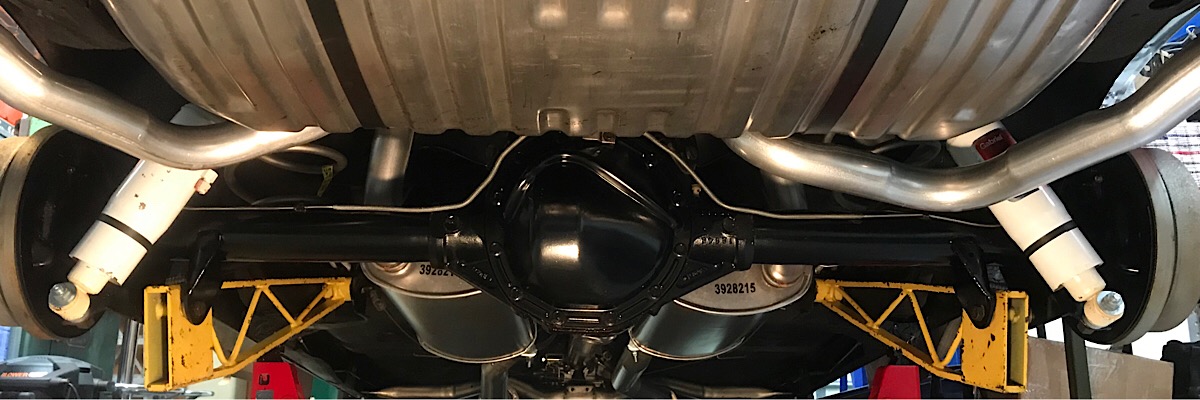

Hey guys, sorry for delay. Just finished loading my baby on the truck. So, these bars in the Ebay ad appear to be what I have. They are called (I think) “traction bars” by Lakewood. Yes, they are replacements for the lower control arms. They help stiffen things up to minimize wheel hop. No mods to the car needed and I really don’t notice a difference in the general ride qualities with these. BTW, I would probably take $299 for mine if I were offered that!!!
Here’s mine:
Sam...
Here’s mine:
Thanks for the reply Sam
The ones in the ebay add have rubber bushings at both ends, do you know if anyone made a version like that?
