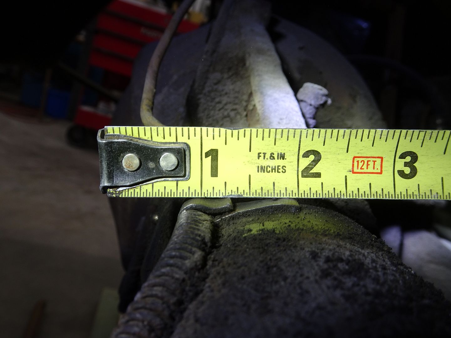

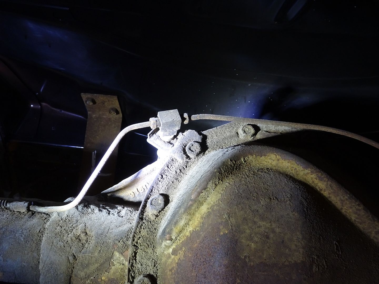

Here ya go. I was rather surprised to see there is only 1 on each side.
They are 1" from the center section.
Nothing special, just a flat stock 1/2" wide and about 1.75 long before shaping. Probably about 10-12 gauge steel. Shape to fit the line, punch a hole and plug weld on.
Detail shaping of the tube end at the cylinder.
Left side is identical.
At the hose bracket for reference.
Mitch
