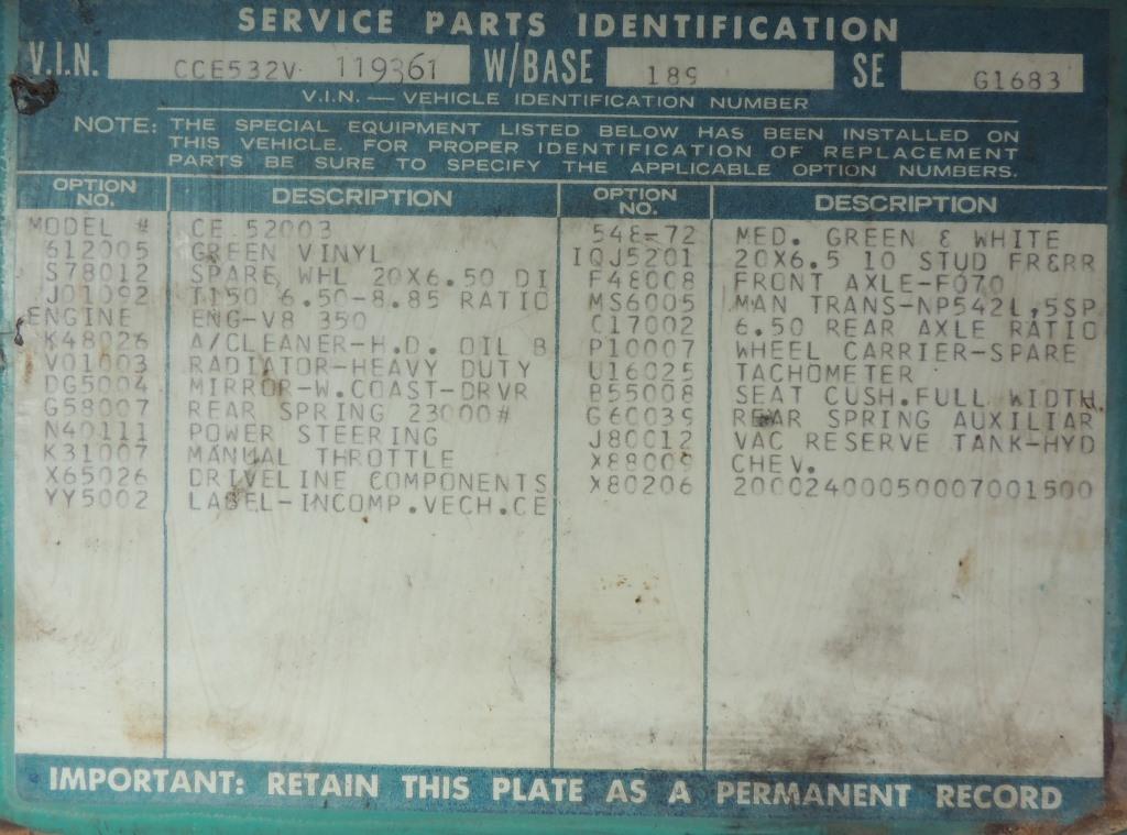

Bought a Chevy engine and trans from BIG chevy grain truck to transplant into my 49 Studebaker farm truck. I think it is a 72 C60. Not sure which 5 speed I got.
Apparently, there were a lot of 5 speeds available back then.
M58 : NEW PROCESS 540GL. 5 SPEED TRANS.
M59 : 5 SPEED CLOSE RATIO TRANS. - NP.
M75 : 5 SPEED NEW PROCESS TRANS
M76 : 5 SPEED CLOSE RATIO TRANS. CLARK
M77 : 5 SPEED TRANS - CLARK
M78 : 5 SPEED TRANS - SPICER
M79 : 5 SPEED CLOSE RATIO TRANS. - SPICER
M85 : SPICER 5752C, 5 SPEED TRANS.
MT8 : SPICER 3152A, 5 SPEED TRANS
MT9 : SPICER 3152F 5 SPEED TRANS
I deleted the 4 speed and 10 speed trans options. I do know this one is a five speed, and it is big. Massive 1.5 inch input shaft.
Truck is being parted out, and is still parked. I am going over there in the morning to get some clutch linkage parts. I know a lot of the 70's chevy trucks have an option sheet taped in the glove box. I am hoping it is still there. I will also get the vin and any data plate info I can. Just need to know what trans I have so I can get some gaskets and seals. Can post some pics tomorrow.

I believe it is a new process based on the shift pattern.
Still, there are 3 to choose from.

New Process 542GL.
Don't you wish all the muscle cars had a data plate on the glove box door.

It's a New Process NP542. The 5 digit casting number on the side of the case would have also identified it. At my old job, we used to sell these for $200-$300 used.
Mike

Yep. Not much market, but perfect for my needs.

Shows had tachometer,those have good value. Same cluster as C10 you should get that if it not gone

I noticed that after I cleaned up the pic and cropped it. I did not even LOOK at the instrument cluster, even when I was removing the speedo cable (which I left hanging) so I don't know if the tach is still there. It is a good 30 miles away, so don't know that I would make the trip just for that. I can make a phone call and find out.
