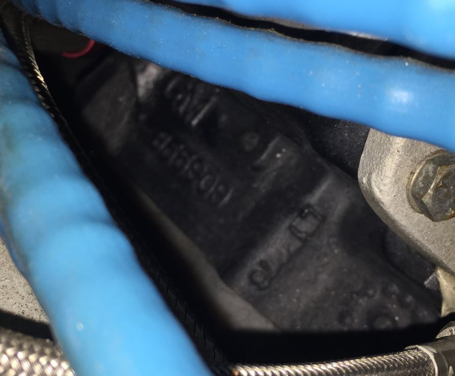

I was reading it backwards and not getting a good look at it - here's a pic, looks like 355909 (305) from I think L 1 of 1978?

Old 09-14-2017, 06:49 PM
Posts: 12,377
Thanks: 18,476
Thanked 5,599 Times in 2,401 Posts
If a 305, the pass' side front extended deck surface pad should be the smaller style, not a large one like the earlier blocks?
Also, the 355909 could be a 262 block as well as 305?

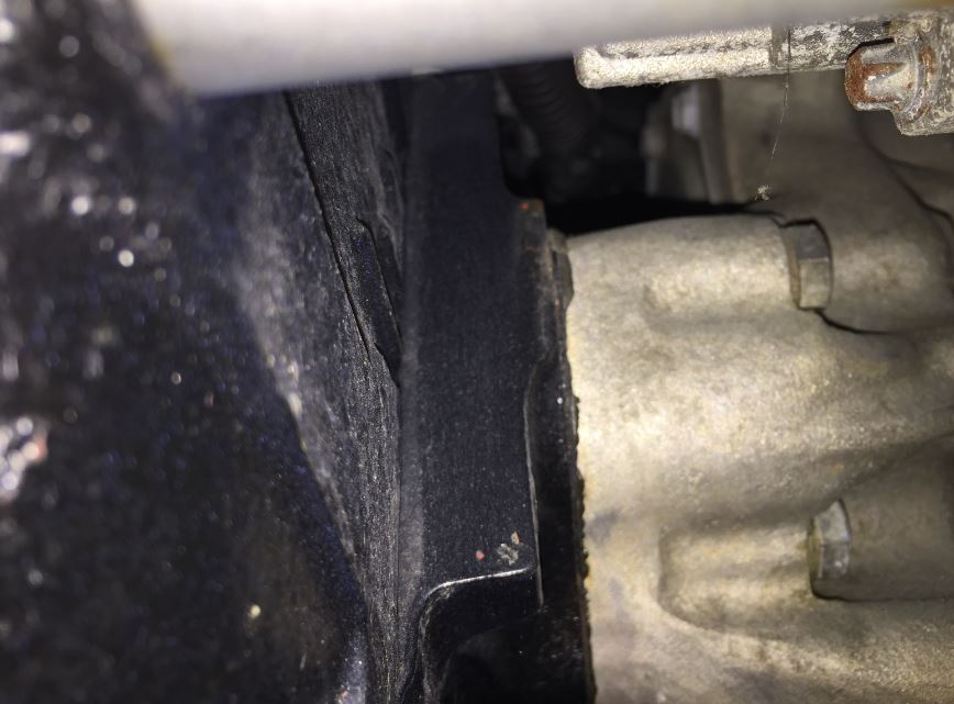

Here's the pad - blank, don't know if it's small or large.

Old 09-14-2017, 07:07 PM
Posts: 12,377
Thanks: 18,476
Pad looks like the large size so probably 75/76?
For sure no stampings under the paint?
