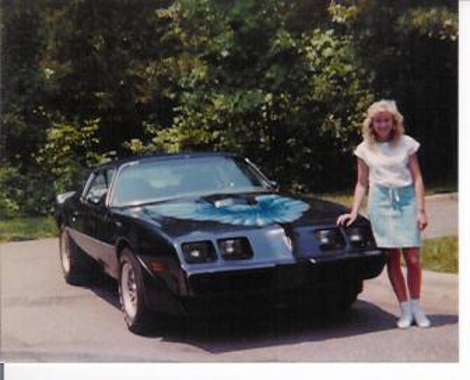

looking to put a high performance motor in a 1979 TA 400 455 or whatever else...aluminum heads ok or not ...only requirements are that the original "shaker" setup be retained which probably means keeping the original carb . . Also not looking to cut up or modify the car/etc

Do you have a certain HorsePower range in mind ?
Do you have a Pontiac core engine available besides the matching # engine to build ?
on side note - is the car a factory 400 4spd or a 403 Automatic ?
Mainly that will just tell if you need a replacement air cleaner base.
The 403 Olds is offset , if you go back with a Pontiac engine , you will need a base that is centered - not offset.
Not that hard to find , just worth mentioning.

It is a 400 4 speed car. Open to most anything Dont have a set budget,if i like it,id spend more I guess. Id like around 400HP, or more Wouldnt mind 400 cu in w aluminum heads and intake w headers and stock carb .....Its a 31K mile car 4 speed with every option black on black w blue decals and 4 wheel discs.But motor was apart when i got it,not for any obvious reason it checked out OK

Wow Steve you really did a number on Granny's Bird.
Seems like i remember that maybe you were upgrading that engine for your son / with your son on PY in the past.
Both of these units were mine in 1985.
Thats not me in the picture, my hair was never that long.
These 4.4.4. TA's would actually wake up quite a bit with some normal cheap easy upgrades. #1 was disabling all emission devices and cutting the scoop open, then true duals and recurving distributor. Mine was fairly swift and i really enjoyed that car.
Little brother was born in 79 , and he's proud to have my 79.
