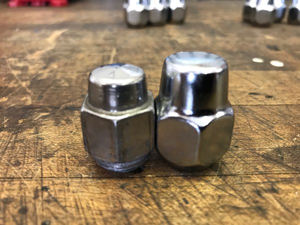

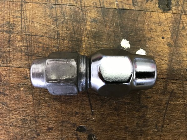

Need some help..looking for lug nuts for my SS wheels. If I remember there is one with a wider seat? GM? my holes are a little sloppy [img]<<GRAEMLIN_URL>>/frown.gif[/img] I had a good set but they have been lost. 7/16-20, cone seat, factory appearing or other suggestions. Thanks!

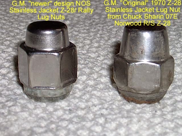

Albert, back in 2003 I ordered a set of these from this place. Hope this is what you are looking for.
Specialized Chevrolet Decals

In-line tube makes a 1pc. solid chrome,(not a capped stainless steel),acorn lug nut that is wider and meets the lower seat width overall of Dons example.It's great for enlarged holed wheels.It has a slightly different profile,meaning no nipple in the top center,compared to the GM 2nd design lug nut.But it does have a shorted hex &amp; a taller crown,like the originals did.Just too exaggerated.
They sell a set of 20 for like $45 shipped on ebay.
...in-line tube solid 1pc.chrome lug on the right.

I had the same oversized hole problem on my SS wheels, If you do not mind the chrome lug nuts work great, they have more surface area. I used a set from Summit on my son's wheels.
I made the pictured washers from grade 8 3/8&quot; washers in a arbor press with a long drift punch and a socket. Ran them for years and they hold the wheel torque without distorting. Hard to even see when installed.
