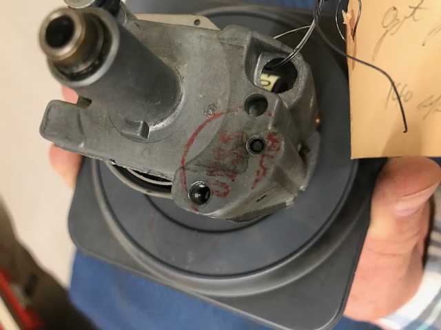

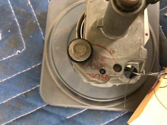

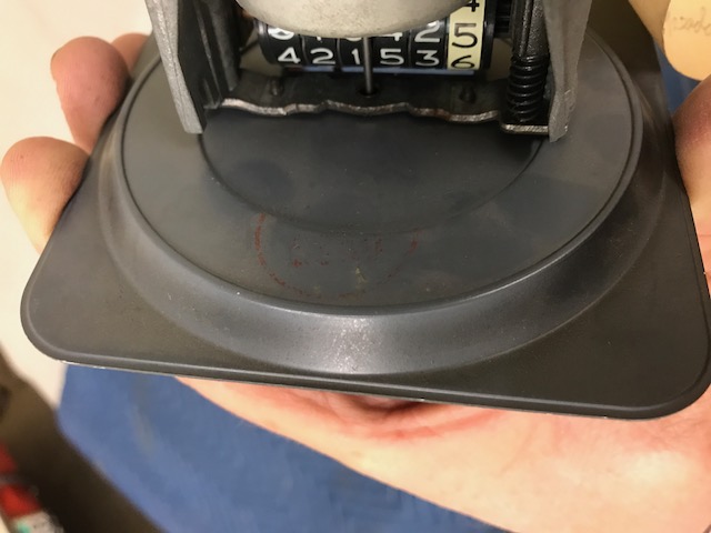

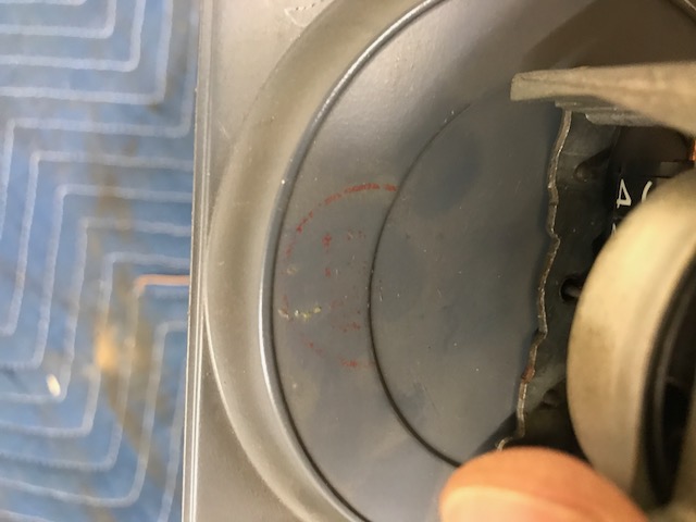

Is this a real one

At first glance, I would say yes just from the position of the 130 MPH hash mark. However, it looks awfully glossy for a factory 1969 speedo.

my exact thought....i am no expert but the first thing i noticed is how shiney/glossy it is..nearly all i have seen are almost flat in gloss

What I see is a decal from the 80's.
That was the first 140 speedo reproduction part available. .
Looks as if the vinyl grain is showing as is the semi gloss black color......
Real speedos are tampoed aluminum (silk screen)
Notice the 2 attachment screws.... the metal body behind the aluminum speedo face is pushed through......via someone's attempt to push a little to hard applieing the decal, then over tightening the screws. .
Just my "used car eyes" as a guide.....

Just take it out and look closely for the decal edges.

In Brent's pic, could the blurriness of the photo be a distortion from being taken through the plastic lense giving the 'grainy' appearance of the gauge where actually its as flat as the others pictured ?
I took two pics of a speedo Behind plastic and one loose.......the face of the black does look distinctly different.......
Looking at all the other info....I'd say Now, Its a Real One.....
Me bad.....
The early reproduction vinyls sure look fuzzy and not flat....
Acrylic lenses are a bit wavey........
