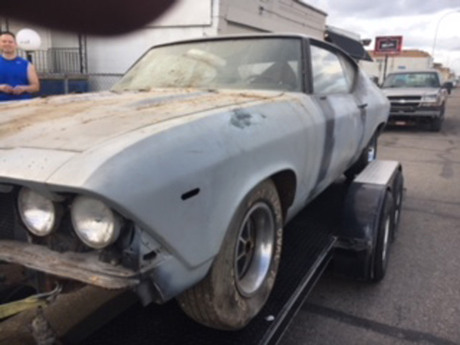

As I’ve posted in the technical area before I discovered this area, I’ll repost my request for assistance.
I believe my brother has located & purchased a very original L78 Chevelle out of a garage in Pennsylvania.
The VIN is 136379Z356459.
Any help is greatly appreciated.
Attachments - The Supercar Registry image4.jpeg.jpg image3.png image2.jpeg.jpg image1.jpeg.jpg

Thank you for the help and responses. I have many pictures that I can post, but I’m having issues posting them. Could anyone here post them for me if I emailed the pictures to them?

The car is in black primer now, but the original color is a dark green. It shows thru where the primer is faded.

Yes, the car has about 95% if it’s original components and they are untouched. The build sheets are completely eaten up by mice, but every paint mark and bolt on most of the car is original. Including the engine, 4spd trans and rear end...the cowl tag is also in place.
