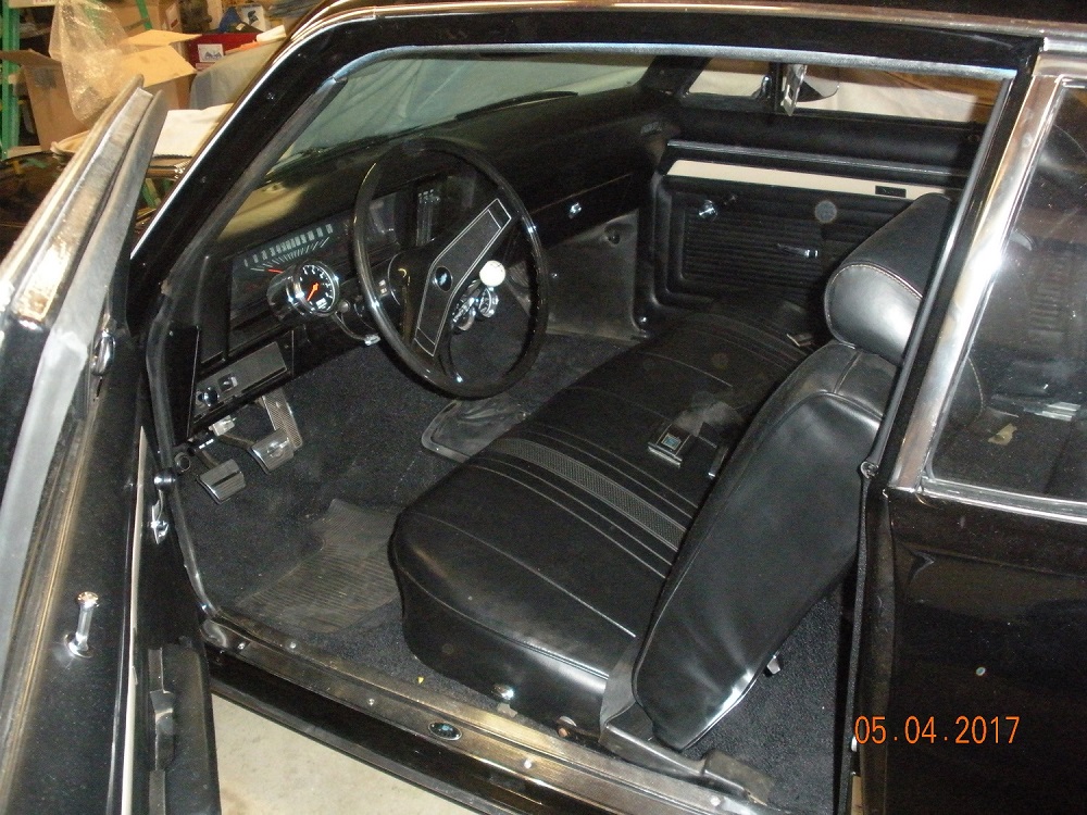

At some point the shifter in my 1969 Nova SS was changed to a Hurst shifter, I like the Hurst but I want the look of original.
I believe my Nova would have had a Muncie. am I correct?
did the chevelle have the same shifter handle as a Nova?
Can anyone help?
My Nova is a 4-speed NO console.
TIA

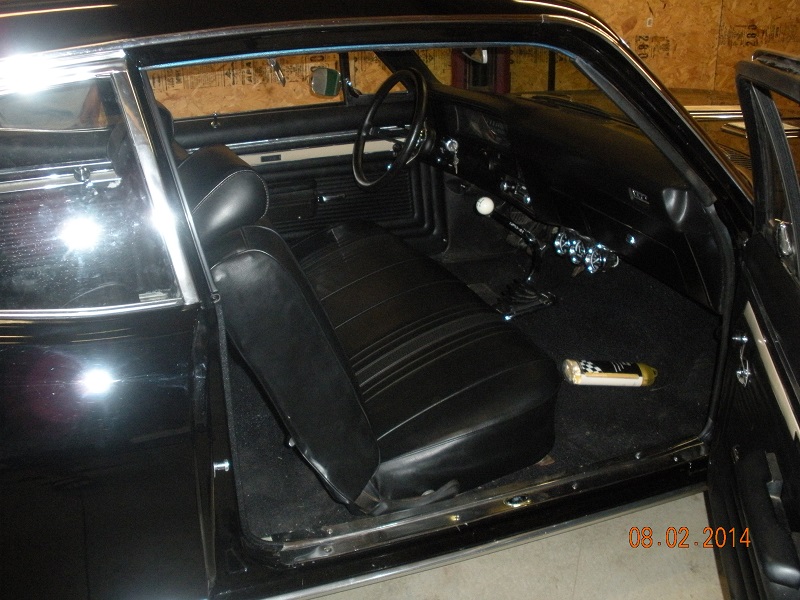

It fits nice and looks stock. I am actually changing it out because I want more of a day 2 look but it doesn't hit anywhere on the dash or seat and is comfortable to drive. Here are a couple pictures, not the greatest but hope it helps.
