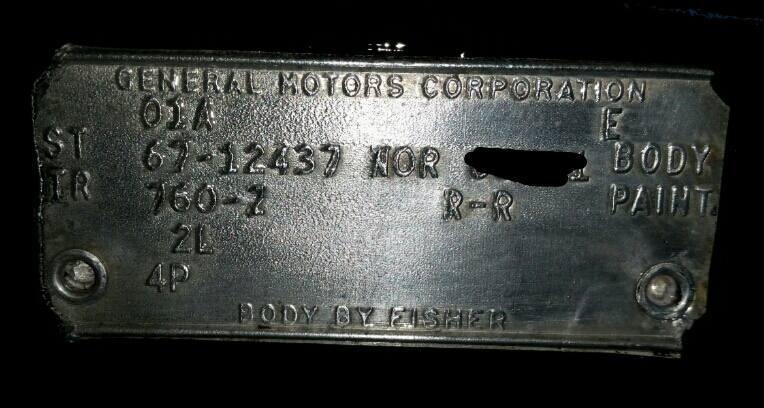

Old 12-08-2017, 02:58 AM
ktcamaro67 ktcamaro67 is offline
Join Date: Nov 2014
Location: Ia
Posts: 190
Thanked 2 Times in 2 Posts
Default Z tag
Here's a cowl tag pic of #6 car
