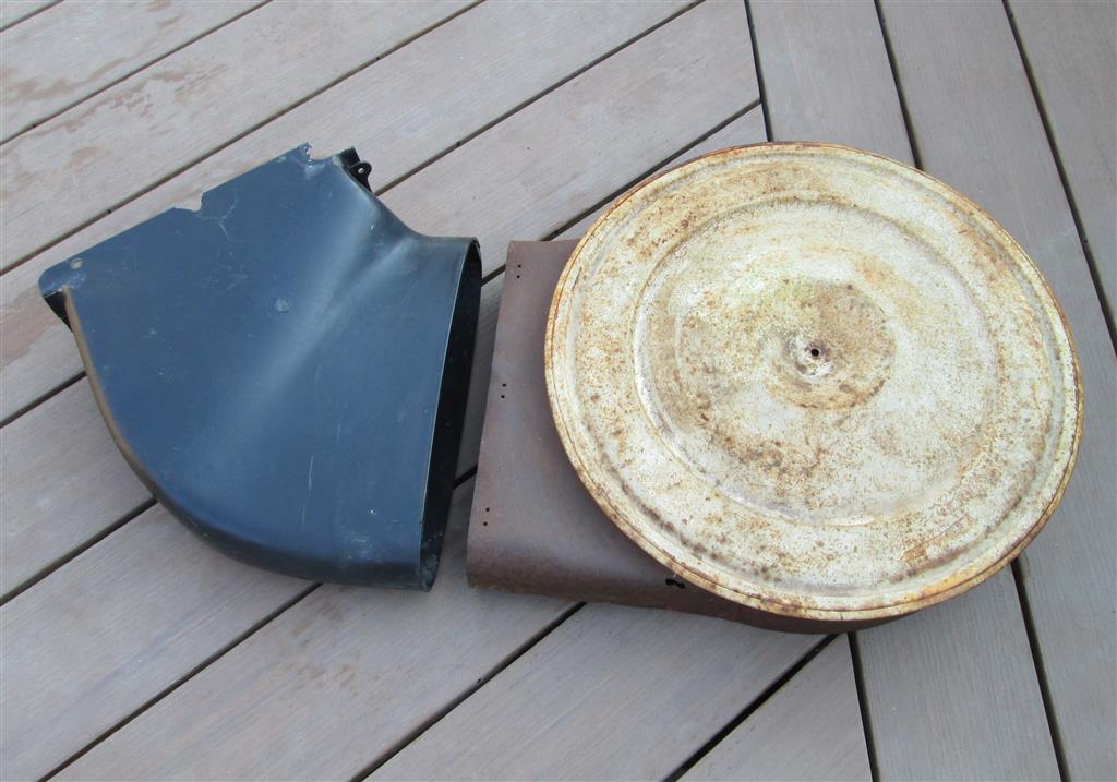

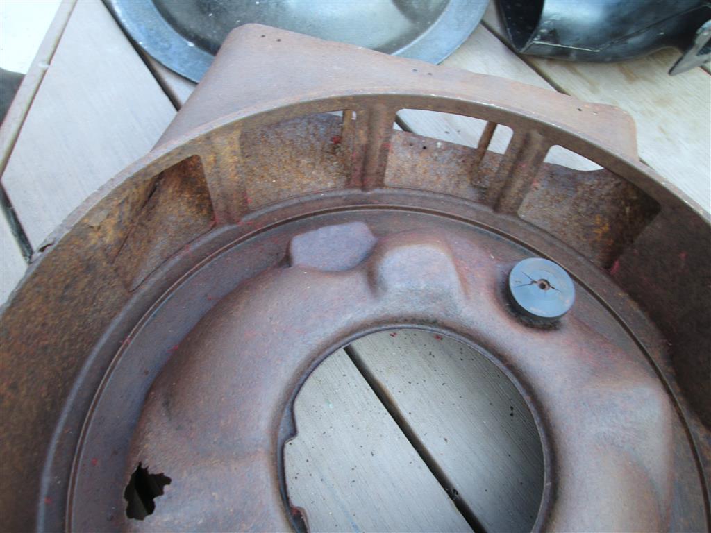

If I'm not mistaken, did I or did I not see this same type of air cleaner, that someone called a "Nascar" air cleaner on a Black 69 L78 Nova SS Barn find on Ebay approximately a week ago? The car sold for $39K. I was telling some friends about this and the air cleaner and I have never seen a Nova with such air cleaner. Well here's one currently listed on Ebay and I was all but certain Nova did not come with this type of air cleaner. After I saw this listing, I'm convinced now. Correct me if I'm wrong here.

Here is the direct link to the auction: I think it's actually a 68 piece since it has the clearance bump for the AIR pump.....

Here is what I know about these units:
The one from PA is a Chevelle/Impala BB unit with the 5 window and the "dent" on the drivers side for the oil fill.
The Camaro/Nova units were SB units with 4 windows and the 1967 has one "dent" for the distributor and the 1968 units have 2 "dents" one for the distributor and one for the air pump.

I'm a Nova guy, so I didn't know this unit even existed until I saw it on that 69 L78 Nova. So is this a Camaro Air Cleaner only, or could this have been a factory install on a Nova, or was that air cleaner just something someone threw on that 69 L78 Nova many years ago leading everyone to believe it was factory because it was a barn find? I don't think this air cleaner was ever a Nova option. Or was it?

I think the air cleaner that was originally posted is one I have listed on ebay. It is also listed here for less.
Here is a link to the listing on ebay:
https://www.ebay.com/itm/352222787499
....and the post here:
https://www.yenko.net/forum/showthread.php?t=145359
This unit is a 1967 Camaro unit with the 4 windows.
Here is another that just sold:
https://www.ebay.com/itm/362153385563
These cowl plenum air cleaners were race parts. Someone certainly could have bought one from the Chevy dealer and installed on a Nova when new.
