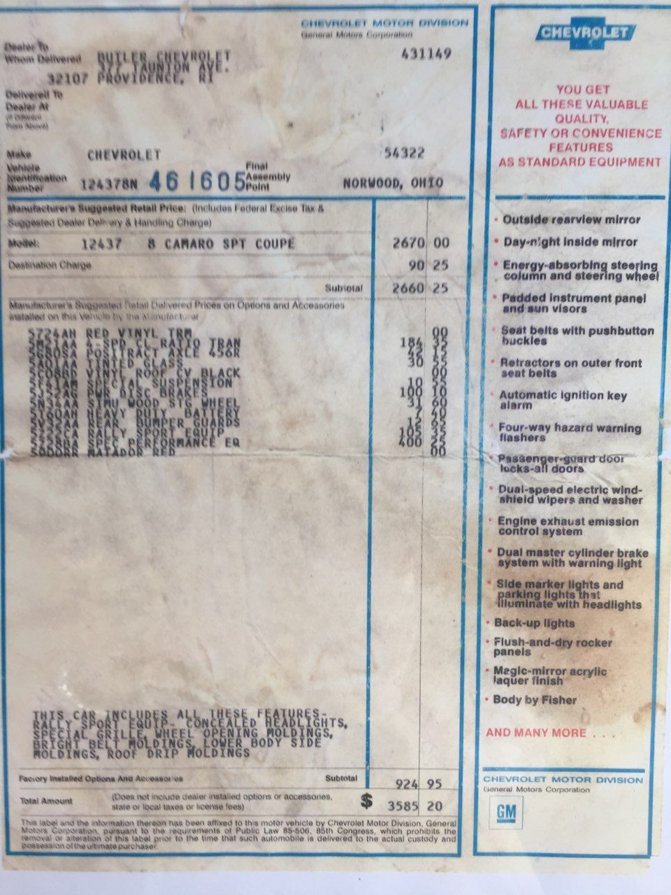

Default Is this WS real or repop?
Real?

That is what I thought. Thanks. I am not an expert on WS, but saw several mistakes.

Default And the POP?
This also a fake?

Ya know Lynn,I take back my earlier statement about the window sticker being 100% re-pop.
I realize now this is a 1968 Camaro,and was referencing it against a '70 model.
I think that WS is real,as there was a difference between those 3 years,and although I don't have many '68's in my database,I think it's real.
Old 02-20-2018, 06:37 PM
Posts: 20,899
And the protecto-plate looks authentic too,based on the few copies of 68's I have.

I've examined, researched, and analyzed hundreds of original Pontiac window stickers (not generic PHS reproductions) in order to make sure all of my Pontiac reproduction window stickers are as accurate as possible. I'm a stickler for small details. I do NOT do aging.
Occasionally I get asked to look at a Chevrolet window sticker to provide my opinion as to whether they are real or repop. I don't analyze Chevrolet option breakdowns or specific formatting, but there are certain details regarding fonts, spacing, and other minutia that allow me to spot a reproduction Chevrolet window sticker quite easily. I have around 20 true original Chevrolet window stickers from 1962-1972, and around 40 reproductions, some aged, some not aged.
That being said, I am absolutely 100% sure that the Camaro window sticker shown above is a reproduction. I would rather not disclose how I know this, because providing this information on a public forum would just allow the people that create these aged reproductions to correct these details.
Mike
1959-1980 Pontiac Window Sticker Reproductions : PontiacWindowStickers.com

The addition on the top portion of the subtotal is not correct.

Wow, the addition of $90.25 actually removed $9.75 from the sub total.

Appreciate that Mike. Freddie, that was the first thing I noticed. Funny math. Maybe Jethro helped add that up.
I think there are several other issues as well.
