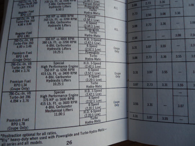

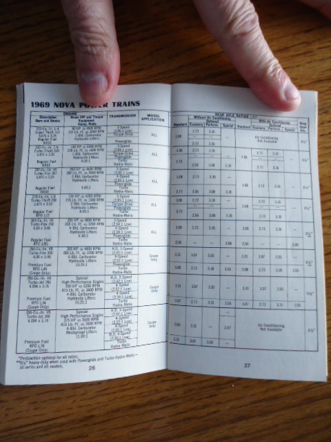

Old 03-17-2018, 10:13 PM
Posts: 20,900
Thanked 3,496 Times in 1,419 Posts
67 Nova Boy
Nope,nor in '69 either according to my Salesmans pocket book.
