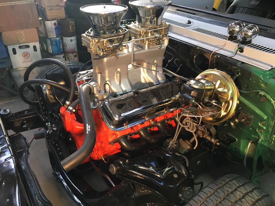

I have a Gen VI 454 +.030" that I'm building. I had the block decked .010" and the heads are razor straight. Does anyone see any issues with running an SCE Pro copper head gasket? They're supposed to be for O ring heads. Mine aren't, but my understanding is that I can use the copper spray and they'll seal fine with flat heads/block. The reason I want to use them is to tailor my compression and quench. Standard gaskets didn't get me where I want to be. With the copper gaskets, I'll be at 9.75:1 and .046". Price is right also at $100.50/pair. I think that will wind up perfect with my roller cam. .241/.249 @ .050 and .625/.625.
https://www.summitracing.com/parts/SCE-P14322
Just because threads with no pics suck, here's a couple of pics of my build progress.

Nothin' like a freshly painted BBC! What kind of numbers are you looking for?
Sam...
Old 03-23-2018, 07:32 PM
HawkX66's Avatar
HawkX66 HawkX66 is offline
Join Date: Sep 2015
Location: VA/MA
Posts: 1,021
Thanks: 1,015
Thanked 225 Times in 134 Posts
I couldn't agree more. I even spent some time grinding casting flash off and smoothing this and that. I wasn't in a hurry... A little cleaning, some Seymour EN48 and a propane torch and whalla. We have a nice Chevy orange big block.

Old 03-23-2018, 07:35 PM
mockingbird812's Avatar
Location: Dayton
Posts: 14,403
Thanks: 908
Some nice flat torque from 2-5. Plenty of HP to have some fun!!!
