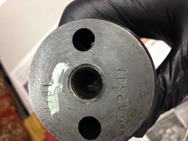

Hello All,
I'm wondering if anyone can help ID this cam I just pulled from a complete "XCH" stamped LS7454? It's a pretty big solid cam, from the videos I have of engine running before I bought the complete motor. The rods are number stamped, so it's been apart- looks to be in great shape so far- just want to know what I'm working with?
Was hoping for original L88 GM cam- but doesn't look like it.
See pic - rear view with numbers stamped.
Any help greatly appreciated.

Jerry,Second design 1969 L88 / ZL-1 / LS-7 solid cam p/n 3959180 - .560I/.600E Lift .262I/.273E Duration @ .050 lift

Wow- Thanks RobbR!!
That really makes me feel good about the engine, now to pull the heads and see what pistons are in there. Much appreciated!

All big block Chevy rods are number stamped, along with the main bearing caps.
