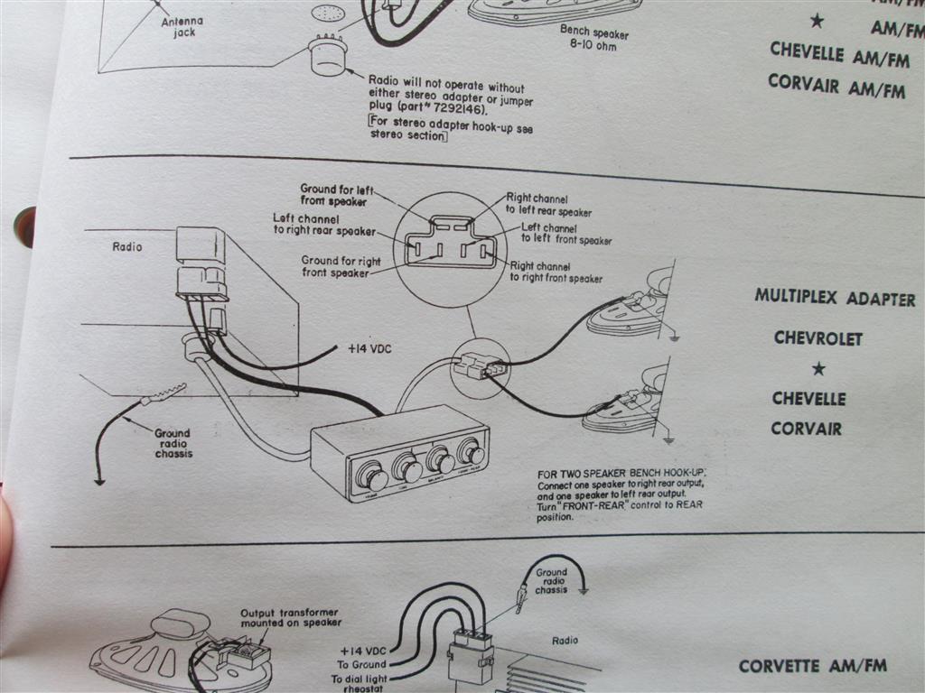

Old 05-04-2018, 05:06 PM
Location: Santa Cruz, CA
Posts: 6,562
Thanks: 392
Here are pictures from a 67 manual I have.
Jason

Old 05-06-2018, 10:39 AM
Geoff Smith Geoff Smith is offline
Join Date: Jun 2014
Posts: 85
Thanks: 7
Thanked 4 Times in 4 Posts
SuperNovaSS ,
Thanks very much for this information.
Looking at the drawings you have provided it only shows two ground wires for all four speakers. One for the front and one for the rear.
Does anyone know if I just run a ground wire from the LH front to the RH front at the speakers?
Also the same for the LH rear to the RH rear at the speakers?
