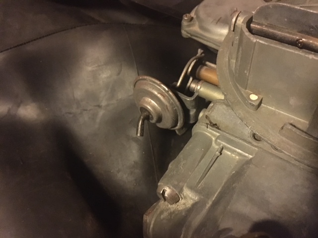

what is the original & correct pull off for 69 Z
Attachments - The Supercar Registry FDCDF037-20A4-42F2-B864-AC143D487BA8.jpeg A25EF54A-FFA5-4938-9A8D-5CA5EDB1E784.jpeg 59A94854-2DB3-478B-8F75-6625606B0838.jpeg 5309CB9A-CCC6-410B-B221-74B69C268178.jpeg

The first three pictures are of an original choke pull off from a late 68 dated 4053, note the bend where the vacuum line hooks up. Later ones are straight like in the last picture. I hope this helps, Rob.

so the only difference is the bend

Pretty much. I have a straight one but not sure when the change over point was. I have an 11D car.
