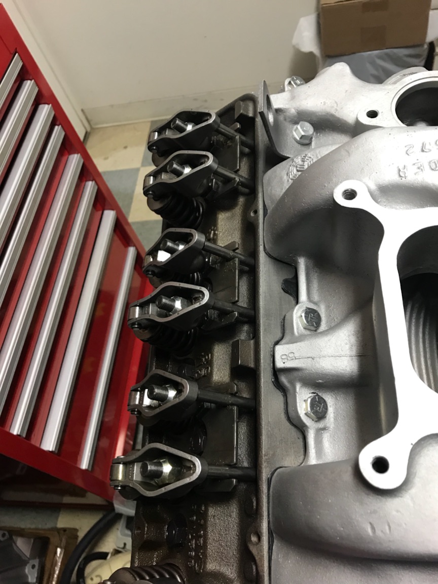

getting organized to assemble my deuce LT1 sbc
what is the correct head gasket thickness for original GM factory assembly application
using all std..original block/ heads etc
thanks
chris

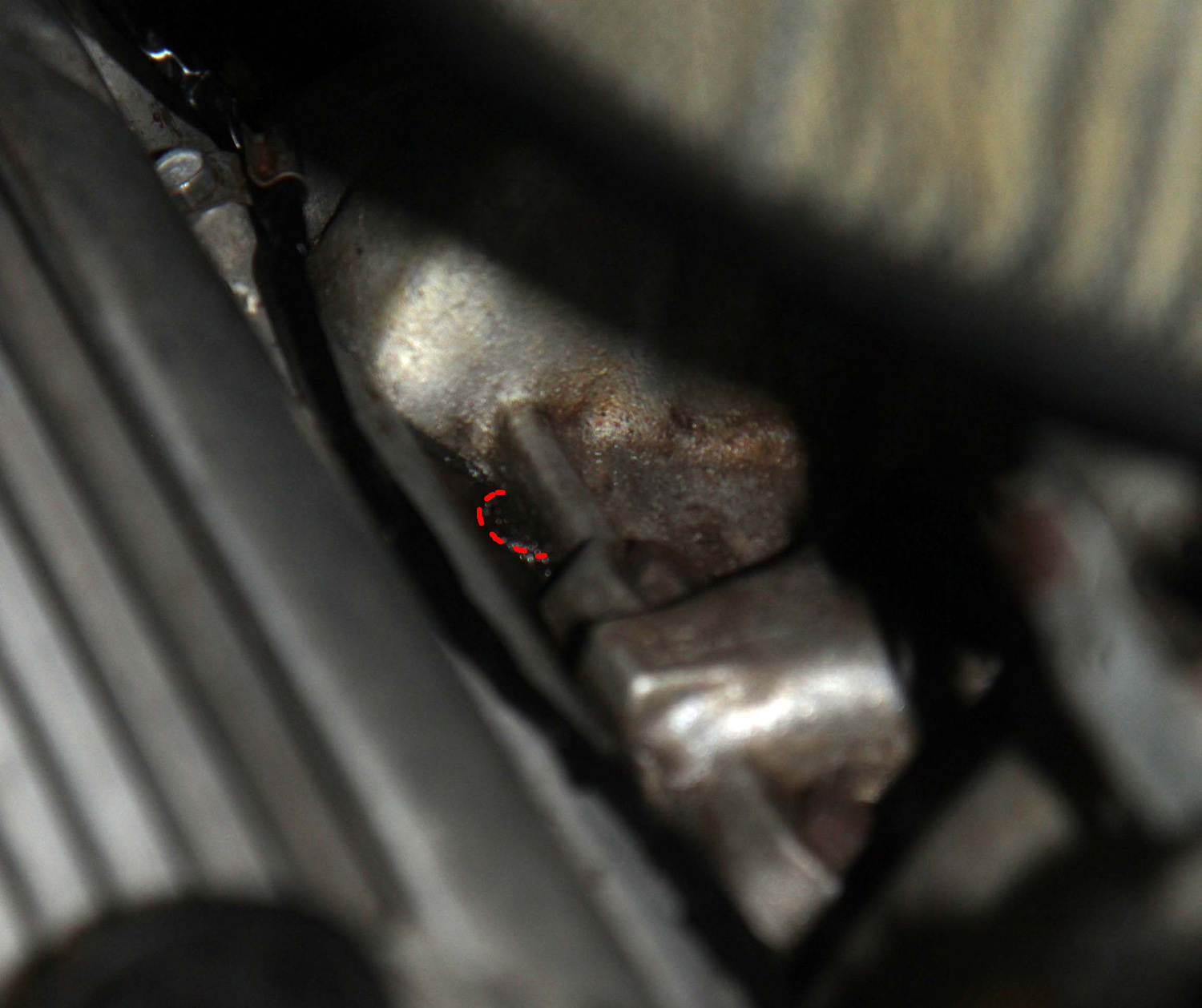

The factory correct intake manifold gaskets are not available, unless you are willing to trim them.
I last paid $450 for a complete set of NOS correct gaskets including the steel shim head gaskets, intake gaskets, and the correct thick black pan rail gaskets.
The red dash shows the correct finger tab on the gasket, the current available has this area completely covered by gasket.
ALSO the correct valve cover gasket is ALL CORK not salt and pepper.

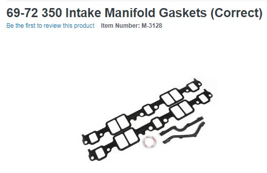

"The factory correct intake manifold gaskets are not available"
Zip Corvette offers a nice version with the tab.
