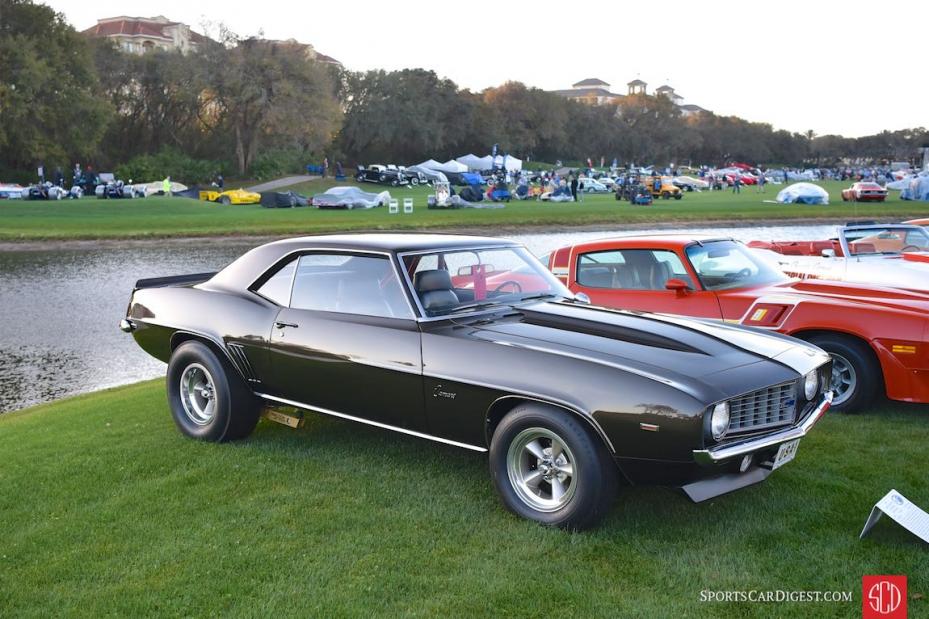

Grady and me decided to start a Members ride on his Burnished Brown 1969 COPO Camaro that some of you saw at this years Day 2 display at the MCACN. We held off sharing shots of the car until it debuted at the show. It looks like it was well received and as it has many period correct Day 2 bolt on parts, more on that later.
The car scored well enough to be awarded a "Day 2 Concours Gold award" , and the one that surprised us both was the "Platinum Pick Judges Choice Best Chevrolet" . There were other outstanding restored and judged Chevrolets that could have easily been chosen. And the real surprise to Grady was receiving The "Helen Gibb Memorial Award" presented to a outstanding participant that shows passion and enthusiasm for our hobby. That award speaks for itself when you see all the Day 2 goodies used on this build.

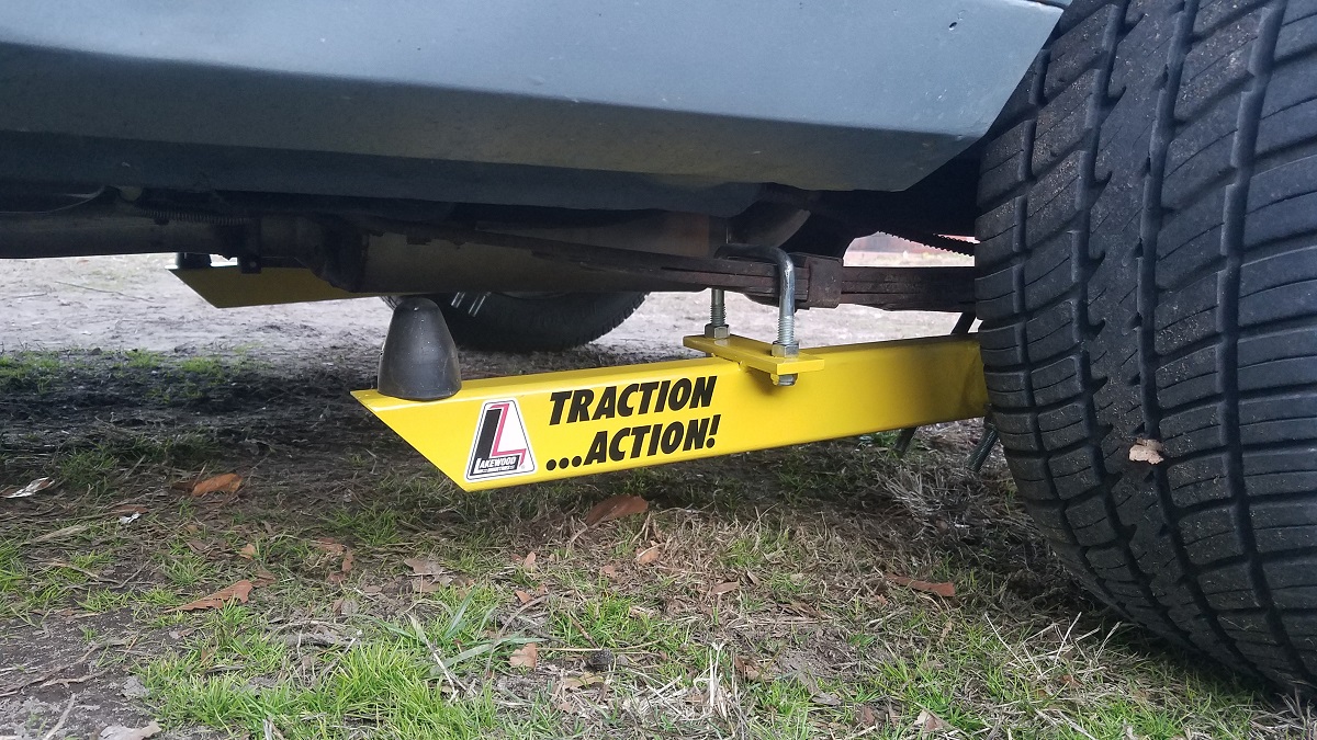

The car as received with Rallys, then Cragers, and then some square tube traction bars

I may be in the minority, but I love BB and the Camaro looks amazing. So you did a full repaint on the exterior of the car? Just wanted to make sure I understood. The shot with those Cragars and Lakewoods is sick. What size rear wheels and tires?

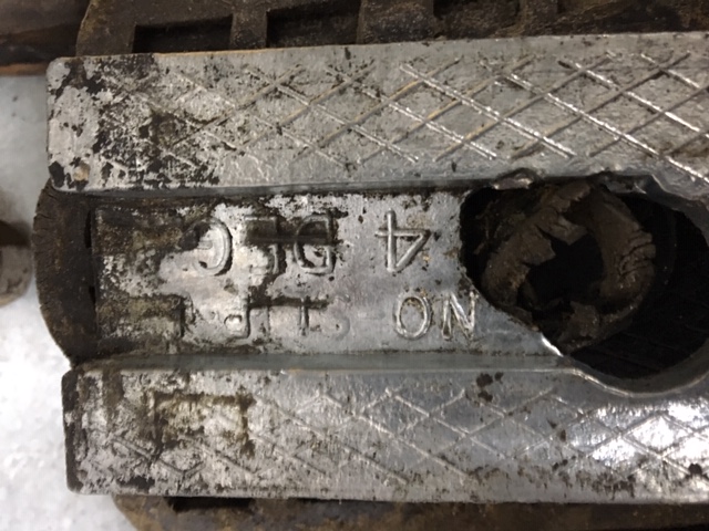

More resto shots, it will take me awhile to get all the shots up.
The born with CX trans covered in rattle can black, most came off with a small wire brush.
Most all the sheet metal was 37th wk
One large spoiler rod
[img]https://www.yenko.net/ubbthreads/pics...2974-53052-box
dscf6501.jpg[/img]
Super clean no pitting and no media blasting
Drive shaft marks
More later

what does the &quot;H&quot; stand for in &quot;H37&quot; on the sheet metal?

that same 42 would be on the gas tank as well!
