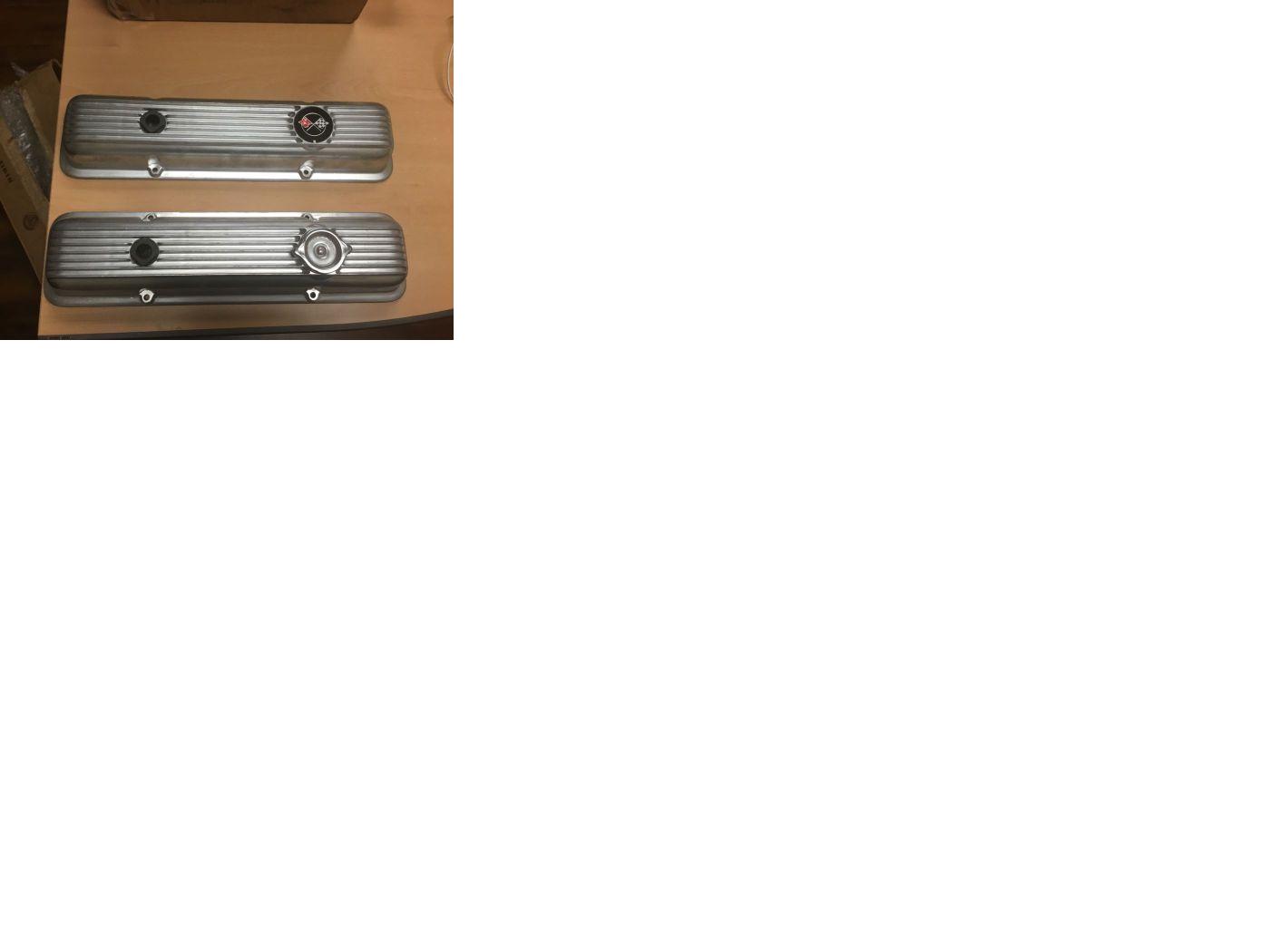

had my deuce LT1 valve covers "vapour honed"
i have an NOS cross flags decal for them....and am now going to re-install the decal on the valve cover
what is the best product to secure/ glue it to the valve cover?
i dont want it to come off when the covers get hot

I would use a clear silicone adhesive self-vulcanized gasketing material. What is vapor honed? Is it like steam cleaned? Don.

Chris - I've used simple 5-min epoxy with excellent results and still "stuck" after many years.

The 2 part epoxy works excellent
