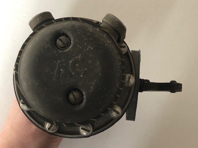

need help ID. this fuel pump
i have a box full of these.............i believe they are bbc AC delco mechanical fuel pumps
some have ac on the bottom and others dont
got them from a gm dealership and was told they were 396/427 hp ????
any help with ID and valve of what they are worth would be great
thanks so very much
regards
chris

Any numbers stamped on the edge of the mounting flanges?

I have a similar fuel pump, outlet and inlet are positioned different than yours. Mine has a small aluminum tag attached under the head of one of the screws on the main body. It has a part number and another number that looks like a build date stamped on it. It looks like your tag may have been lost.

What size thread are on the in and out

no stamped numbers on flanges
inlet and out let are both 1/4 NPT thread on them
i also have a few nos pumps with the 4 screws in the bottom and look identical to the bbc fuel pump on ebay presentlly for sale.... item number below
eBay item number:133037425107
that is what is making think they are assemble line bbc hi-perf fuel pumps

AC made rebuildable fuel pumps like the one pictured for small block & big block Chevrolets. GM part # 6415325 is for the Corvette HP small block & # 6415748 was for the Corvette big block. These fuel pumps were recommended by Chevrolet for racing usage back in the day. I believe the only difference was the fuel pump arm (lever). Big Blocks were usually stamped either 40170 or 40731, Small Blocks had the metal tag with the stamped number. Small Blocks had the cast aluminum bottom cover as shown, Big Blocks had either the cast cover but more often had the stamped steel gold iridite cover. Don.

Looks like they may have been made by Carter.

I’m thinking this is a low HP pump.
As I remember, all the High HP pumps stick out away from the block
by 3/4” or more like on the 40394 L-79 ChevyII Pumps
1965 L-79 was the same way.
A completely different top casting.

Looks a lot like a 409 hp pump.

Big block high hp pumps used 3/8 lines
