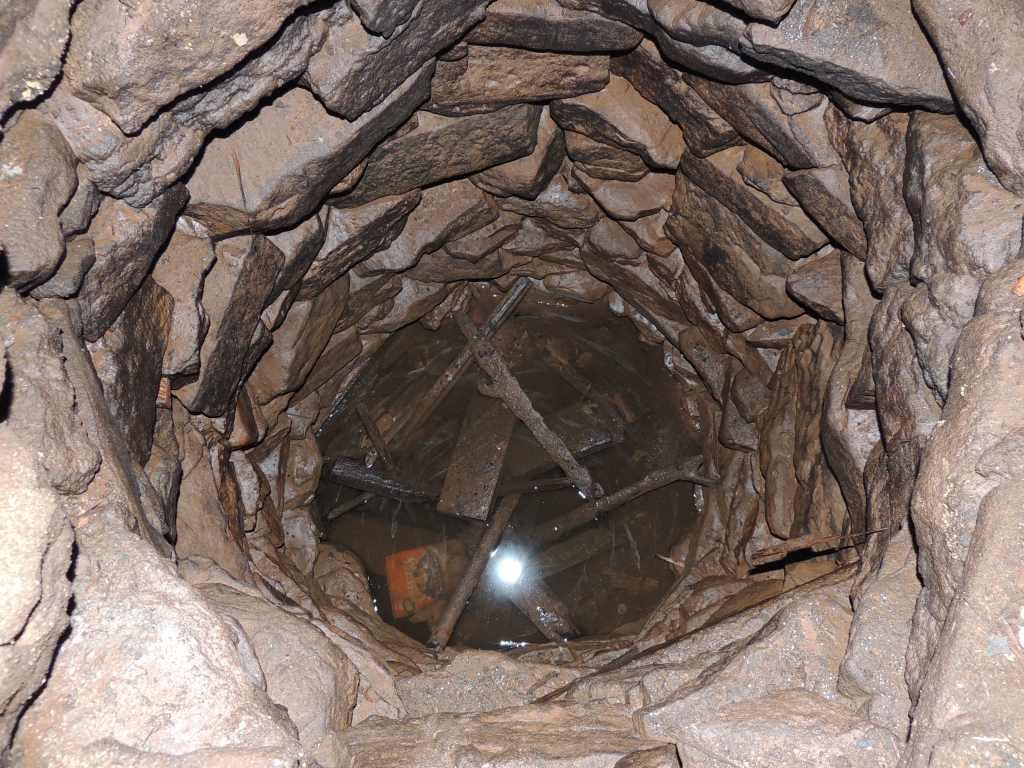

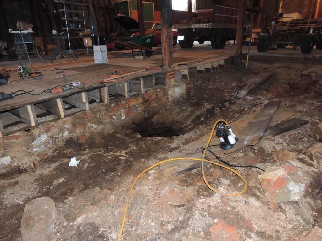

OK, so here is your weekend laugh. I get in the biggest messes sometimes. I posted a while back about an old (built in 1919) warehouse I bought to convert to shop space. I had initially planned to just convert the lower 1/3, about 1400 ft, to shop space. Then I got greedy. The middle third was still the original wood floor. Huge 16 foot 2 x 12 trusses with 2x6 Douglas Fir flooring. I decided to remove all the wood flooring and concrete the floor to add another 1200 ft to my shop space. I go the flooring removed for free, as I had some friends that wanted that 100 year old Doug Fir (zero knots!) so they paid a couple of guys to pull it. What could go wrong? Well, turns out the wood floor was built over an existing artesian well. That's right, a well, right in the middle of what will be my floor. Rather than fight the well (it is about 7 feet deep, three feet in diameter, and fills up completely after just 1/2 inch of rain... obviously spring fed), I plan to leave it there and install a 30 inch manhole cover over the well, so I can maintain the sump pump. On top of that the water table is about 6 inches deep. So, Sherri and I are installing a huge drain system under where the slab will be. Luckily, I have plenty of room on the South side of the building to run the drainage for both the weeping pipe and the sump pump.

Yeah, I know, I need to post pics. What a mess this place is right now. Can't even get it graded until we get the drainage system installed. Will take about 380 feet of 4 inch perforated pipe. We keep saying: "What a mess.... but it will be cool when done."

Here's a shot of just a 1/3 of the flooring pulled up, and another looking down the well after pumping it out. Have not cleaned all the debris out yet, and probably won't until I get the manhole cover and concrete in place.

Boy, that's an unexpected cool surprise! You've gotta find somebody with a metal detector to go over that before you pour the new floor.

Kind of cool and spooky at the same time. Had no idea what we were going to find in there.
I have a metal detector and will make a sweep before putting down road fabric. So far we have found a vintage Pepsi bottle, a vintage Coke bottle, several old very large pistons (about 6 inches in diameter... assuming some kind of farm equipment) and a couple of half pint whiskey bottles.

Not only that, but think how much we take our fresh water for granted. Some guy had to dig that hole. Have no idea how deep it goes. I will clean it out some after we get concrete in there. Then they laid those stones (which they also had to dig up) in the tubular shape you see. We have no idea what year the well was dug. But, I am betting late 1900's. I believe there was another structure there at one time, close to where this one is. Haven't had a chance to check land records and see if there is a clue. Pretty sure you would not be allowed to build right over an existing well today, at least not in municipal limits.

Did you mean late 1800's?? Hey, when you clean the debris out and if it's not too deep, see if you can run the detector coil down there. Maybe it was somebodies wishing well!
