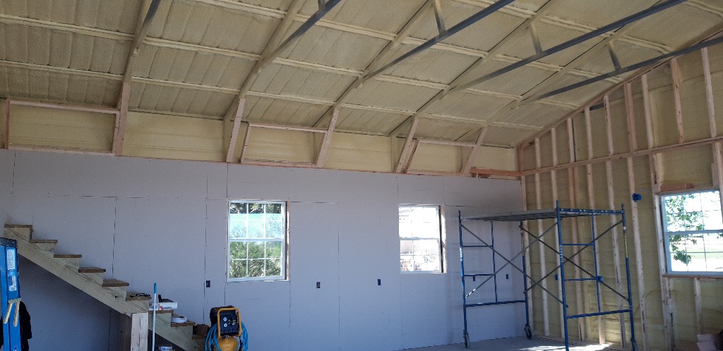

Concrete on 1/2 of the 15,000 sq.ft. driveway which includes the shops and barn!! I just started framing the shops out for electrical. More to come....
