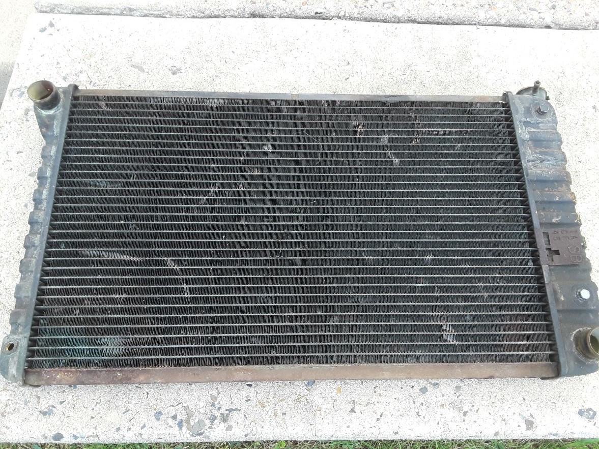

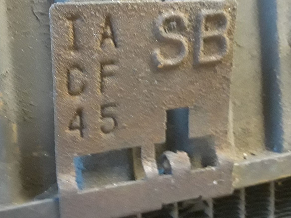

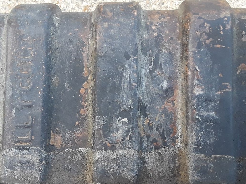

Just came across this radiator. I was told it was removed from
a 1970 Chevelle. Has the original metal tag on the side and has
the letters I A embossed on the one of the tanks. Also, near the
FILL COLD stamping there are the letters C F embossed on the tank
as well. Any help in decoding this radiator and it's usage would be
great help so that I may post it for sale. See pics....Thanks guys.
Sal
P.S. Does have HARRISON stamping by the water neck.

It measures 16 inches high and about 32 3/4 inches wide. Appears
to possibly be a 2 row...?

That is an SB radiator.

Used on 1970 Monte Carlos & Chevelles equipped w/350/250HP,350/300HP,307/200HP,all with PowerGlide Trans.

What's the number on the bottom edge of the tag?
http://www.camaros.org/coolingsystems.shtml#tag
