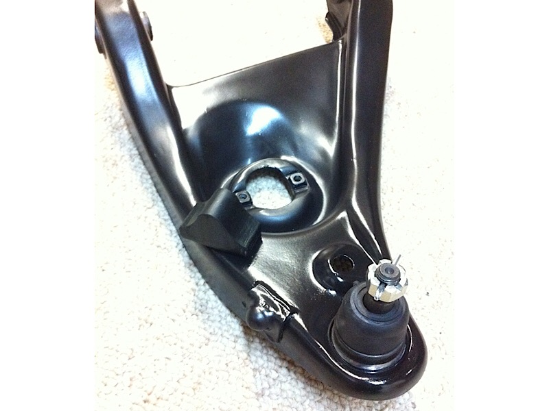

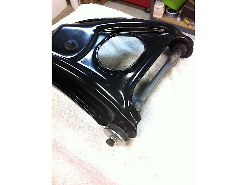

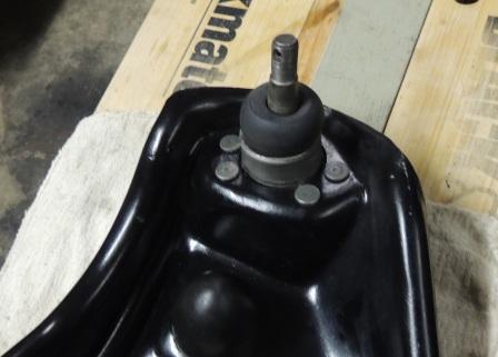

who does correct upper control arm restoration ,including reriveting ball joints in...this is for a 1970 gm a body ..thx keith

Keith,
After sandblasting and painting I had Bair’s Corvette rivet the ball joints in and press in the bushings on my ‘68 Camaro control arms. They did a great job.
http://www.bairscorvette.com
Bob

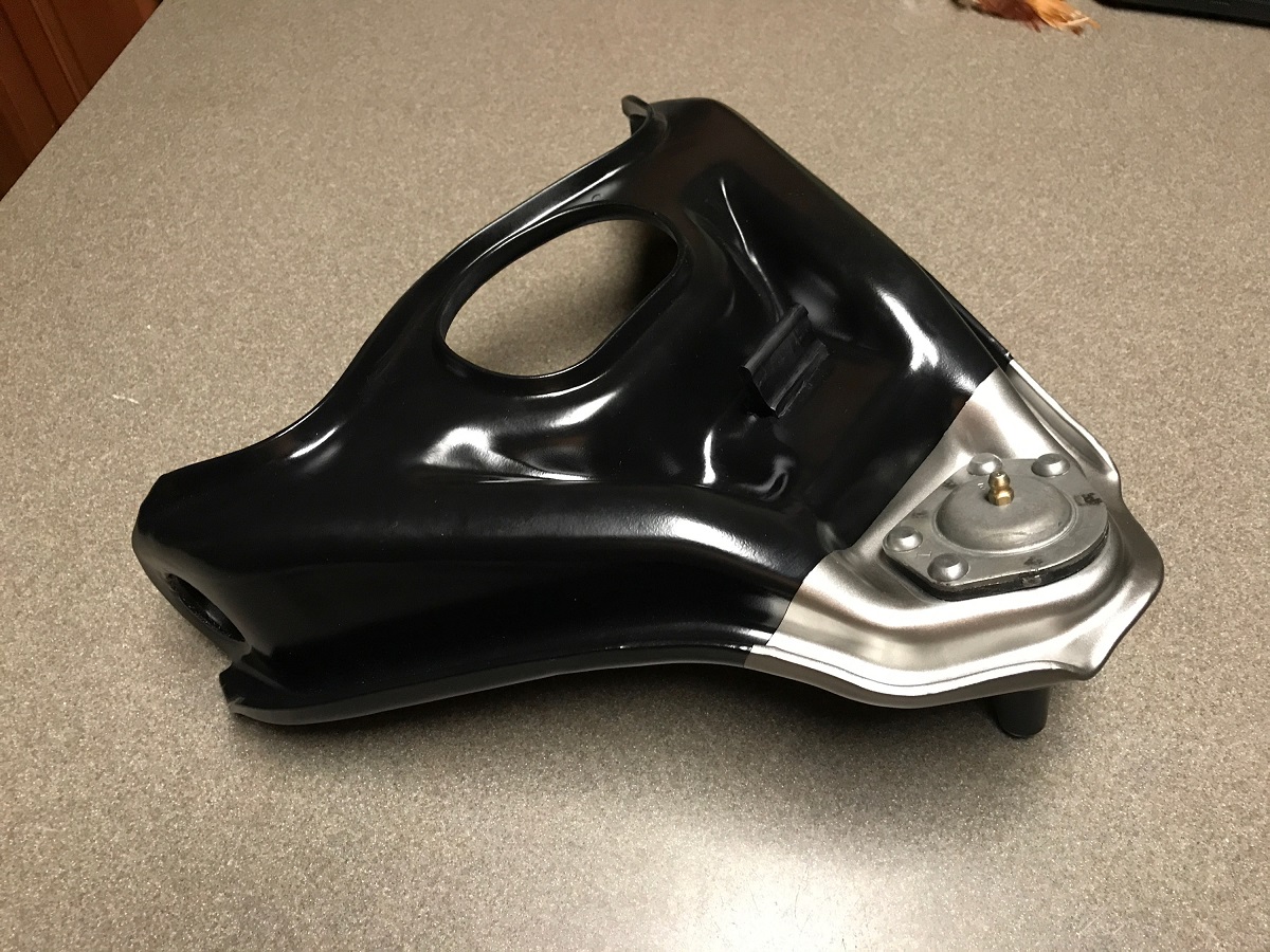

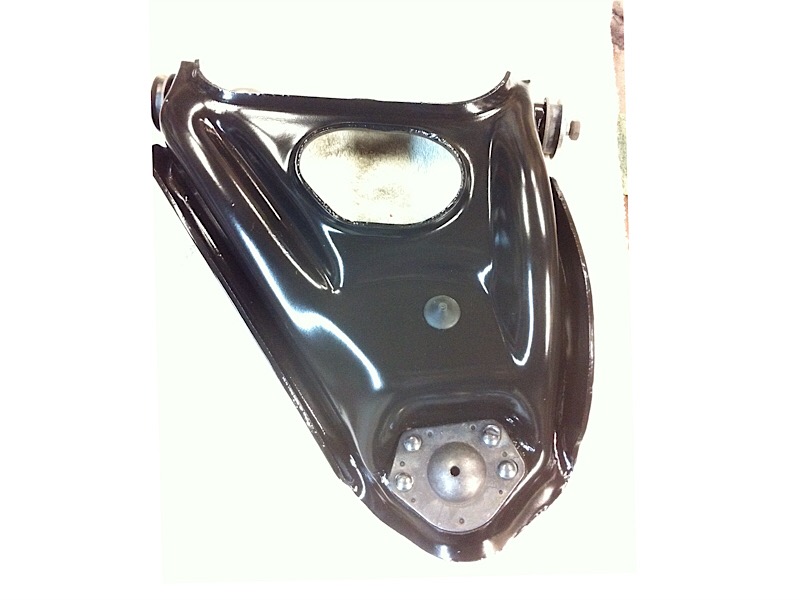

Default Button Style Rivet
Anyone know a good source for riveting button style with the flat? Bair cannot do these. Shown is a '70 camaro. Do any other models share the same type?
I had a close friend do mine and he milled a flat onto standard ball joint round head rivets.

Those are super nice. Is your source open to do others? I have the arms and spot-welded ball joints.
