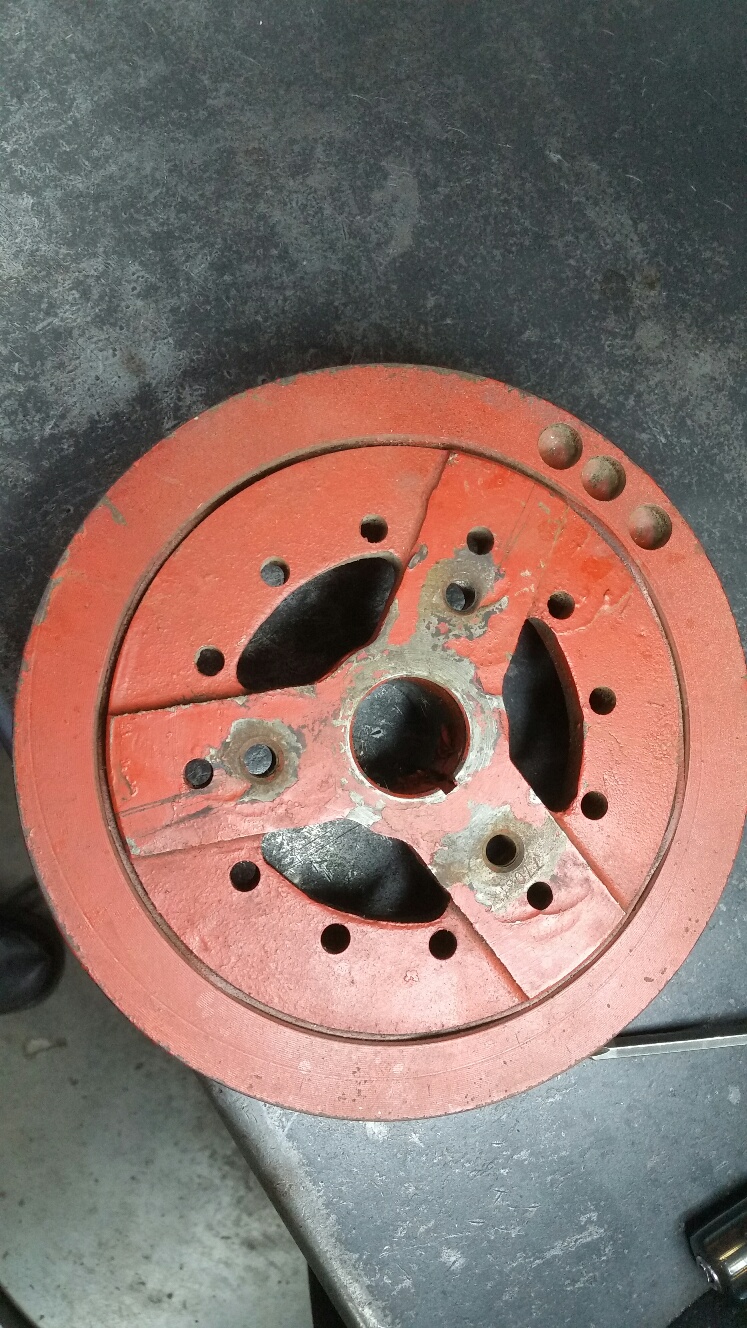

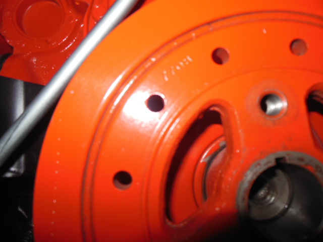

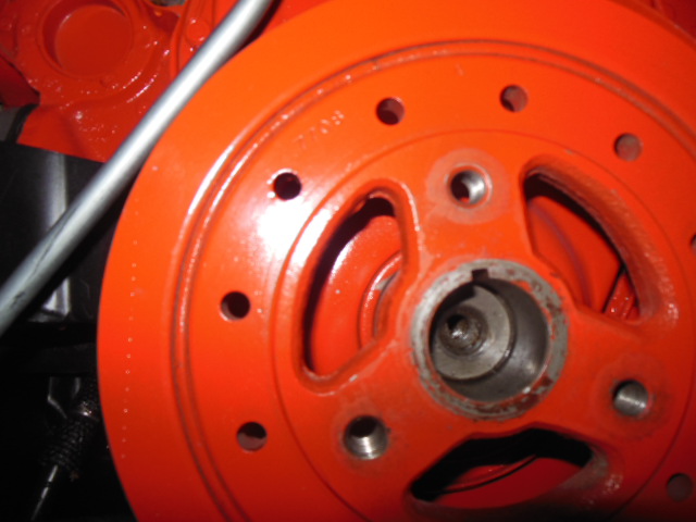

Is this the correct balancer for a 69 z/28 THE STAMPED #IS 7708

Posts: 20,896
Yes it is,part #3947708.
Yes it is, except it's not assembly line correct. If you are restoring a car to show or for correctness that is not the balancer to use. If you are building a driver and only functionality is necessary that will work. Correct assembly line balancer pictured below.

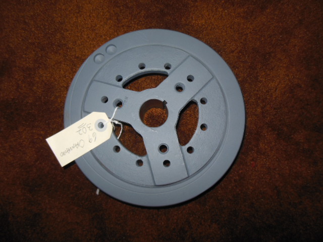

Default balancer
ok I see the difference it should be like this one I have . thanks guys for all the help

Thanks: 751
Assembly line balancer should be stamped 7708M.

Thanked 121 Times in 66 Posts
yes the one I pictured has 7708M

Thanks: 751
Can't make out the 'M', but assume that's on the grey balancer?
I have one stamped 7708E on my CE 302 and it is a later service replacement with the shorter fingers that don't extend out to the rubber.
